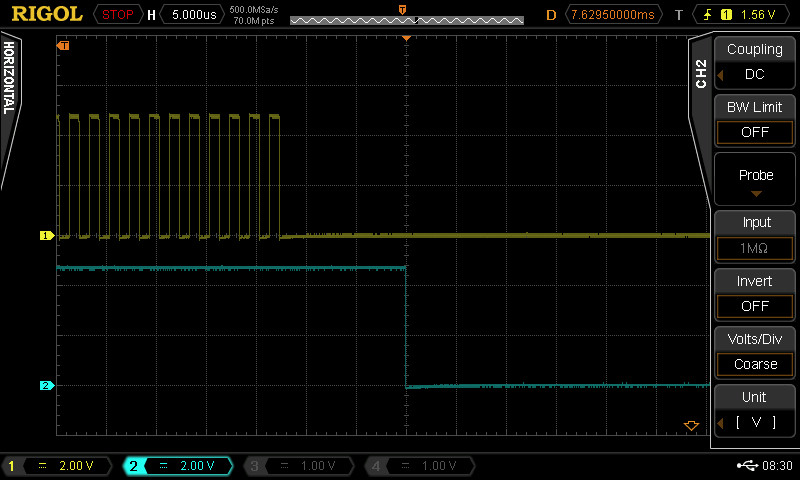

    No problem, I didn't have a 12F683 at home but I did have a 12F1840. Now, the 1840 has an ECCP module while the 683 has a standard CCP module so the following code MAY need to be changed slightly (the CCP1CON register) in order to work properly on the 683 (I'm not using the data modulator here). It sets the CCP module up to output a 1MHz, 50% dutycycle PWM on PortA.2. The main program then simply toggles the timebase (TMR2) for the CCP module on and off to modulate the output.
    ' Pin Connections
    ' RA0                       -> Not used
    ' RA1                       -> Not used
    ' RA2                       -> CCP1 output
    ' RA3                       -> Not used
    ' RA4                       -> Not used
    ' RA5                       -> Not used
    ' Device Fuses
       __config _CONFIG1, _FOSC_INTOSC & _WDTE_ON & _PWRTE_ON & _MCLRE_OFF & _CP_OFF & _CPD_OFF
       __config _CONFIG2, _PLLEN_OFF & _STVREN_ON & _BORV_LO & _LVP_OFF
    ' Compiler directives
    DEFINE OSC 8               ; We're running at 16Mhz
    ' Initialization
    OSCCON   = %01110000        ' 8MHz internal osc
    ANSELA   = 0                ' Digital only for all PortA pins
    TRISA    = %00000000        ' Make PORTA outputs
    CCP1CON = %00001100     ' Normal PWM
    PR2 = 1                 ' 1MHz output @8MHz system clock
    CCPR1L = 0              ' 50% Dutycycle
    CCP1CON.5 = 1
    CCP1CON.4 = 1
    ' Actual program
        T2CON.2 = 1             ' Timebase ON
        PAUSE 15
        T2CON.2 = 0             ' Timebase OFF
        PAUSE 5
    Goto Main
    I have a scope screen grab of the output but for some reason the file upload manager on the forum refuses to work, the upload just hangs...aarghh....
    Now, if you intend to do other things with the PIC as well then this simple aproach obviously won't work. But you could use a timer interrupt in order to turn on and off the carrier at the correct intervals. I haven't personally used the data signal modulator module in the 12F1840 but it sure sounds like the "correct" way forward. The 12F1840 also allows you to run at 32MHz using the internal oscillator and 4x PLL which would allow you to get higher output frequency using the CCP module than on the 12F683 which tops out at 8MHz.

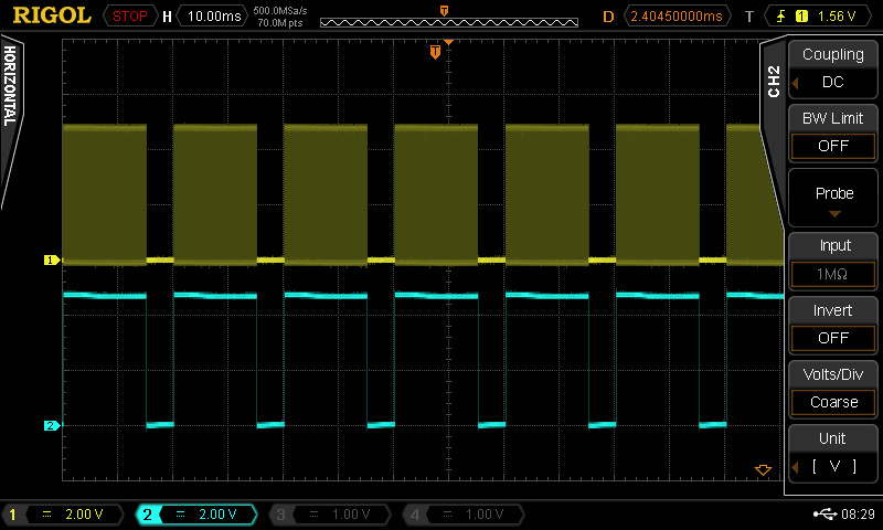

    I had to make few minor changes to Henrik’s code to adapt it to a 12F683 and make the code compatible with my old PBP 2.47.
    Here is the working code that generates bursts of 15 mS ON and 5 mS OFF with a carrier frequency of 1MHz (Sorry Henrik for mutilating your nicely commentated code but REMing some of the lines makes it easier on my eyes).
    @ device  pic12F683, intrc_osc_noclkout, wdt_on, mclr_off, protect_off
    DEFINE OSC 8            ' We're running at 8 Mhz
    OSCCON=%01110111        ' 8MHz internal osc
    ANSEL   = 0             ' Digital only for all PortA pins
    TRISIO=%00100000        ' Make PORTA outputs
    CCP1CON.5 = 1
    CCP1CON.4 =1

    I'm going to try to add two screen-grabs from the scope. Last time I did the uploader didn't work but hopefully that's fixed by now. Nope the bloody thing still doesn't work, sorry but you'll have to trust me that it does work here.

    Yes, as long as the loop takes longer to exectute than the period time of the PWM signal (2us in this case) it'll work without additional delay in there. When running at 8MHz each ASM instruction takes 500ns so there's really only time 4 instructions in this case. The Goto Main takes 2 and the jump caused by the IF-THEN takes 2 so that's 4, then we have the rest so it's pretty safe to run it without any delay.
    Here are the screenshots I mentioned:

    The signals look really good. Only about 12 uS delay on the falling edge which is better than I need. Is it the same at the rising edge?
    Nick
    Default Re: Maximum frequency output from a PIC
    Hi Nick,
    Yes and no....
    Yes because it's going to be in the same ballpark.
    No, because it's not going to be an absolute number (on the rising OR falling edge) because the carrier signal might "come on" (or off) at any time. If it happens to do that just before we check it the delay will be very short, if it happens to do it just after we just checked the delay will be a little longer.
    I measured a couple of pulses here.
    Delay on rising edge: 10, 7.5, 9.5, 10, 7.5, 6.5 us
    Delay on falling edge: 9.5, 11.5, 12, 8, 8, 11 us
    So I think you can consider 12us to be around the worst case for this particular code. Would you prefer constant delay at the cost of it being longer? (Not promising anything, just asking).
    And, don't forget it's Programmers Day today - the 256th day of the year! :-)
