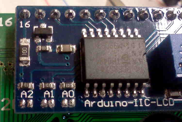

    I bought one of these Arduino I2C 20x4 LCD modules.
    I got the LCD module in today. It has a slightly different back board, but that's not a bad thing. They extended the A0, A1 & A2 slave address pins out to solder/short PCB pads. This will affect the advertised address from 7 bit address of 0x27 (A0:A2 all "1"s) to a 7 bit address of 0x20 (A0:A2 all "0"s). Shorting the jumper pads ties the pin(s) to +5V. At least the modules slave addresses can be easy to change and set... that's a good thing! I was expecting to get stuck with a fixed slave address.
    Again, the web site is wrong about the advertised module address - it is 0x20 as shipped, not 0x27, at least for the module they sent me.
    Past that, it's using a basic I2C bi-directional I/O expander IC - PCF8574T.
    Addressing the module is pretty strait forward, though the data byte being sent needs to be constructed as follows:
    LCD runs in 4 bit mode - DB4 : DB7 are data bits - DB0 : DB3 are not connected at all.
    Data Byte sent via I2C:
    bit7 = B/L LED (0=on; 1=off)
    bit6 = RS (Register Select)
    bit5 = R/W (Read/Write)
    bit4 = E (Enable)
    bit3 = DB7 data
    bit2 = DB6 data
    bit1 = DB5 data
    bit0 = DB4 data
    All the normal commands are available under HD44780 datasheet, including 2-way communication with module.
    BTW, the soldering was very good when I got it. Due to my test probe use to confirm the hookup, it looks worse then when I got it.

    'ARDUINO IIC LCD GY-LCD-V1
    'PIC 12F629
    'PRINTS " HELLO RCG!_"
    Define OSC 20
    DEFINE I2C_SLOW 1
    CMCON = $7
    OPTION_REG.7 = 0
    C VAR GPIO.1
    D VAR GPIO.0
    ADDR VAR BYTE
    ADDR = $40
    CMD VAR BYTE
    LCD_CMD VAR BYTE
    E VAR LCD_CMD.BIT4
    RS VAR LCD_CMD.BIT6
    E=0:RS=0
    LCD_CMD = 0
    PAUSE 1000
    LCD_CMD = $2
    GOSUB LCDWRITE
    GOSUB LCDWRITE
    LCD_CMD = $8
    GOSUB LCDWRITE
    LCD_CMD = $0
    GOSUB LCDWRITE
    LCD_CMD = $E
    GOSUB LCDWRITE
    LCD_CMD = $0
    GOSUB LCDWRITE
    LCD_CMD = $6
    GOSUB LCDWRITE
    RS=1
    LCD_CMD = $44
    GOSUB LCDWRITE
    LCD_CMD = $48
    GOSUB LCDWRITE
    LCD_CMD = $44
    GOSUB LCDWRITE
    LCD_CMD = $45
    GOSUB LCDWRITE
    LCD_CMD = $44
    GOSUB LCDWRITE
    LCD_CMD = $4C
    GOSUB LCDWRITE
    LCD_CMD = $44
    GOSUB LCDWRITE
    LCD_CMD = $4C
    GOSUB LCDWRITE
    LCD_CMD = $44
    GOSUB LCDWRITE
    LCD_CMD = $4F
    GOSUB LCDWRITE
    LCD_CMD = $42
    GOSUB LCDWRITE
    LCD_CMD = $40
    GOSUB LCDWRITE
    LCD_CMD = $45
    GOSUB LCDWRITE
    LCD_CMD = $42
    GOSUB LCDWRITE
    LCD_CMD = $44
    GOSUB LCDWRITE
    LCD_CMD = $43
    GOSUB LCDWRITE
    LCD_CMD = $44
    GOSUB LCDWRITE
    LCD_CMD = $47
    GOSUB LCDWRITE
    LCD_CMD = $42
    GOSUB LCDWRITE
    LCD_CMD = $41
    GOSUB LCDWRITE
    LCDWRITE:
    I2CWRITE D,C,ADDR,[LCD_CMD]
    E=1
    E=0

    I also found this code written by norohs difficult to work out and eventually I decided that it works more by accident than design and that there has to be a better way of doing this. This is what I worked out.
    The LCD works in four bit mode which makes every byte sent a four bit control nibble plus a nibble of data. To send a byte of data two bytes have to be sent consisting of a control nibble plus high data nibble then control nibble plus low data nibble.
    To send "H" which is $48
    requires two LCDWRITE instructions
    LCD_CMD = $44
    GOSUB LCDWRITE
    LCD_CMD = $48
    GOSUB LCDWRITE
    In each instruction the first 4 after the $ sets the R/W bit to write and $48 is made up from the 4 and 8 in red.
    and "D" would be
    LCD_CMD = $44
    GOSUB LCDWRITE
    LCD_CMD = $44
    GOSUB LCDWRITE
    and to print "DHD" would be
    LCD_CMD = $44
    GOSUB LCDWRITE
    LCD_CMD = $44
    GOSUB LCDWRITE
    LCD_CMD = $44
    GOSUB LCDWRITE
    LCD_CMD = $48
    GOSUB LCDWRITE
    LCD_CMD = $44
    GOSUB LCDWRITE
    LCD_CMD = $44
    GOSUB LCDWRITE
    Looking at the LCDWRITE
    LCDWRITE:
    E=1
    E=0
    each command is sent three times with E=0 then E=1 then E=0 which I think is an error, the first line is not needed.
    LCDWRITE:
    E=1
    E=0
    but you can test this.
    Why send it twice? On the LCD with the E bit set to 1 the data is loaded into a buffer and E has to change from 1 to 0 for the data to be transferred to the screen which is why the second instruction is required.
    I decided to look for a better solution as I was not totally confident that the above was correct.
    Darrel Taylor came to the rescue here
    http://support.melabs.com/threads/98...F8574-20x4-LCD
    As you can see from this not all Arduino LCDs are wired the same. The control and data nibbles can be either data/control or control/data.
    johncouture worked this out for us in the thread above.

    Darrel Taylor's program seems to be a work of art but I think with the INCLUDE, it's just too big for my 12F629 as I am getting, "Unable to fit variable" errors.
    I did not realise you were using a pic12f the dt code won't work on those chips because
    ARRAYWRITE is not supported on 12-bit core PIC MCUs due to RAM and stack
    constraints
    Jun 2013
    12
    Default Re: Interfacing with Arduino I2C LCD
    I believe Darrel Taylor was using a 12F1822. Doesn't that have the same "bit core" as my 12F629?
    According to the Microchip datasheet on the 12F1822,
    "This family of devices contains an enhanced mid-range 8-bit CPU core"
    Jun 2013
    12
    The PIC numbering system was getting me confused so I spoke to an engineer at Microchip and this is what I was told...
    The 12 in the 12F629 means it is an 8 pin chip. (I didn't ask why 12 means 8 or why they just didn't just call it an 8Fxxx)
    The 6 after the F means that it has a 14 bit memory core, since anything other (? # > 5) has a 14 bit memory core.
    A 12F5xx chip would be an 8 pin chip with a 12 bit memory core...
    So it does not seem to a 12-bit core problem but rather an overall memory problem.
    The 12F629 has 1k x 14 memory (there's that 14 bit core again), where as
    the 12F1822 has 2K 14 memory.
    I ordered some 12F1822s to see if I can get Darrel's program working.

    Hmmm, unfortunately, I just figured out that my Silver version of PBP3.0 doesn't support the 12F1822...
    2,631
    a pic12f1xxx is an enhanced midrange device . they have twice the stack capacity of a 12f6xx device , apart from more memory etc ....
    Jun 2013
    12
    Thanks to everyone that helped out.
    I have gotten a modified version of Darrel's code to run on a 12F683 which has 2K of memory.

    Mar 2008
    59
    I am trying to make this code work with a 16F629A and all I get is a blinking back light with the modified code below.I am probably missing something simple?
    ; Filename : Test_LCD_PCF8574.pbp
    ; Author : Darrel Taylor

    2,631
    16F629A ?
    might you mean 12f629 ?
    if so you need to set the " lcd " pins to digital
    Mar 2008
    59
    Sorry, I should have said 16F628A. I did set my pins as digital? I want to display data from my program but that seems far away at this point?? I cut the program down to the below lines and I get a custom character and a blinking cursor the backlight stays on. I guess that is progress ?
    Thank You!

    2,631
    there is more info here . note the slightly differing versions of the include
    INCLUDE "LCD_PCF8574.pbp" ; Include LCD module for PCF8574
    INCLUDE "LCD_PCF8574a.pbp" ; Include LCD module for PCF8574
    http://support.melabs.com/threads/10...hlight=PCF8574
    ps
    LCD_Addr CON $7E is way different to addr used in above threads
    Mar 2008
    59
    Richard thank you for your help.
    I have read most of the threads but will read them again. I will find and download both version of the include. On Arduino this is the Initialization for my display the 3F turns into 7E when you shift the bits one to the left.
    "LiquidCrystal_I2C lcd(0x3F, 2, 1, 0, 4, 5, 6, 7, 3, POSITIVE)"
    I have used serial lcd displays in the past with no issues. So far I am not a fan of this i2c version. I think someone is missing a market for easy to use i2c displays?
    Thanks again!
    2,631
    interpreted as [( 7bit_addr, EN, RW, RS, D4, D5, D6, D7, Backlight, POLARITY) ]
    the PCF8574 datasheet indicates the 7bit addr range is 0x20--0x27
    0x3f is not valid afaik.
    default with a0:2 open = 7bit_addr of 0x27 , pbp addr would be $4e
