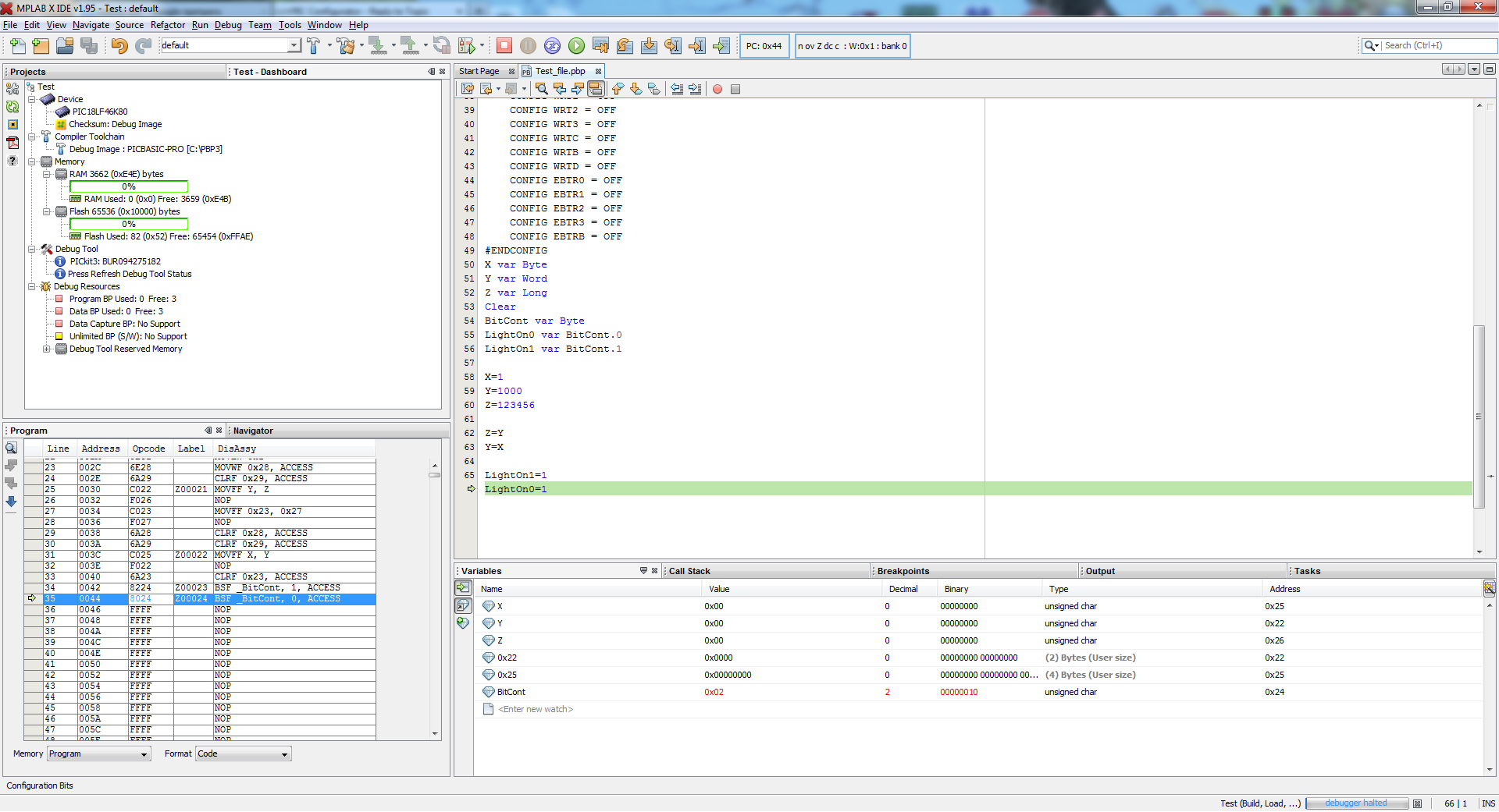

    Add few lines, try to debug... Right click on toolbar to customize, to add step, Add PIC memory view, configuration bits, etc...
    Attachment 7151
    Now there is little problem with debugging WORD and LONG var's and bit's. Just with that
    As you can see, only first byte is showing.
    Add new watch, but this time by entering address of variable, not name.
    Watch are case sensitive.
    Attachment 7152
    And select size of var(WORD=16bit, Long=32 bits),
    And now we can see actual value in variables.
    Define byte container for bits, eg
    BitCont var byte
    LightOn var BitCont.0
    And then add BitCont to watch... Another way is to find PBP's byte container in .mac file if I can remember correctly. Right click to customize layout...
    Attachment 7153
    Note that address of Z isn't same. So watch out for that. Every time when variables is added/removed, check address...
    Check out local history by right click on file name
    Attachment 7154
    And save often, sometimes when I pres shift and "[" or "]" by mistakes, it should just add char "{" or "}" but 99,9 won't add char, it will freeze...
    On 1.70 version after minute or so you can click save button if you have luck. On this version seems to stuck forever...

    Watch are case sensitive. As you can see you can watch variables:
    http://www.picbasic.co.uk/forum/atta...achmentid=7153

    Duble click on last line(<Enter New Watch>), and just type name, then enter

    Also open Program memory window so you can see each step.
    If you have arrays, open RAM(file registers window).
    To find address of first element, add array to watch. This will show only first byte, but also show address, so you can easy locate start of array in ram.
