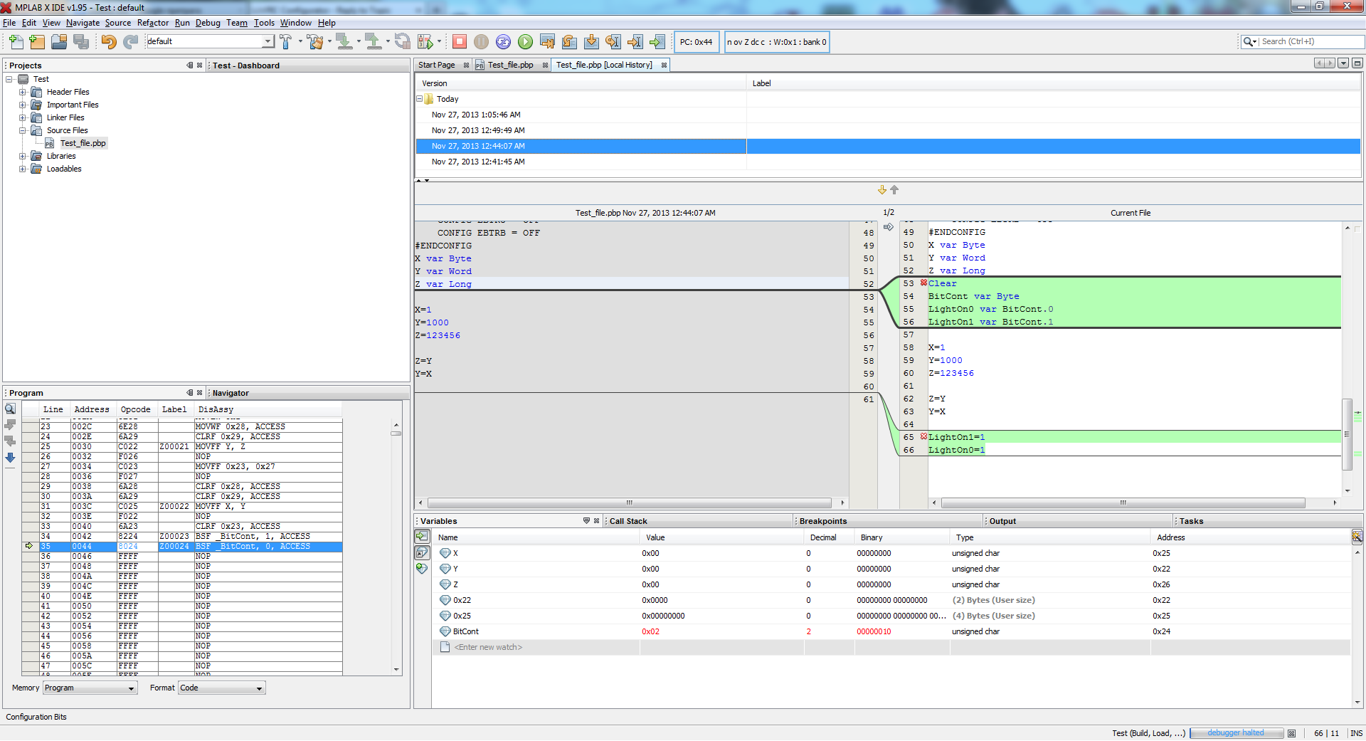

    Now there is little problem with debugging WORD and LONG var's and bit's. Just with that
    As you can see, only first byte is showing.
    Add new watch, but this time by entering address of variable, not name.
    Watch are case sensitive.
    And select size of var(WORD=16bit, Long=32 bits),
    And now we can see actual value in variables.
    Define byte container for bits, eg
    BitCont var byte
    LightOn var BitCont.0
    And then add BitCont to watch... Another way is to find PBP's byte container in .mac file if I can remember correctly. Right click to customize layout...
    Note that address of Z isn't same. So watch out for that. Every time when variables is added/removed, check address...
    Check out local history by right click on file name
    And save often, sometimes when I pres shift and "[" or "]" by mistakes, it should just add char "{" or "}" but 99,9 won't add char, it will freeze...
    On 1.70 version after minute or so you can click save button if you have luck. On this version seems to stuck forever...
    I hope this will be helpful...
