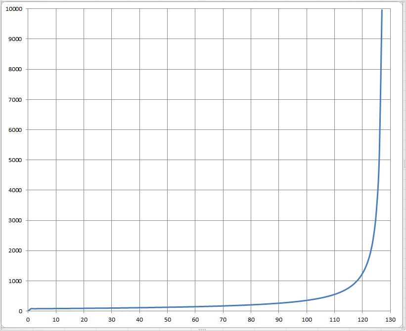

    The attached is a graph of Tone # versus Frequency.
    It is based on my frequency measurements which are slightly different.
    Interesting as to the logarithmic response.
    Wondering about the how/why the Sound function came into being?
    Certainly not straight forward and must involve some magic!
