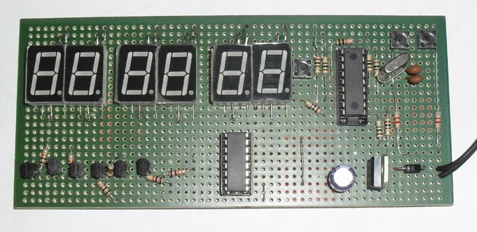

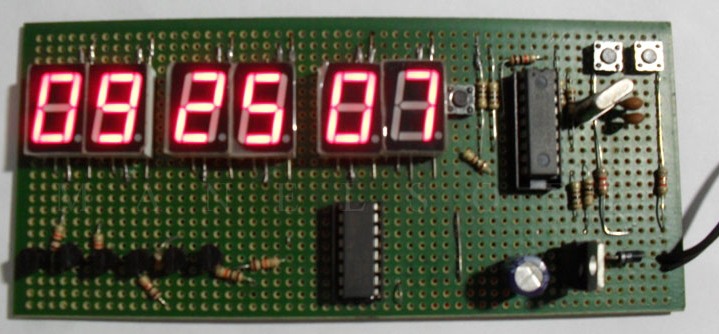

    Hi Friends,
    This is a PIC16F84A Microcontroller based digital clock. It displays hours, minutes and seconds using six 7 segments displays.
    The circuit has three push button switches to reset and set hours and minutes.
    It shows time in 12 hour format.
    Use the following link to download schematic, source code and compiled hex file -
    http://www.manelsoft.com/projects/pi...tal_clock.aspx

    Default Re: PIC16F84A Microcontroller based Digital Clock
    Nice
    But I have to ask.. There's a left over pin on portB, 3 more on PortA,
    and the extra chip is only giving you four more pins than it's using.
    Nice effort. However there seems to be no inter-digit blanking thereby giving the display a washed out appearance.
    I suggest you modify this routine to create the blanking
    DELAY		MOVWF PORTB
    		DECFSZ	DEL,1
    		GOTO	$-.1
    		MOVLW 0FFH
    		MOVWF PORTB
    		CALL CLOCK
    and remember to turn PORTB back to 0FFH to be able to read your keys
    Cheers
    Jerson
