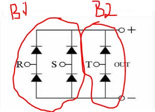

    actually, you only need 2 full-wave bridges to rectify 3 phase.
    2 legs to AC inputs on 1 bridge and use 1/2 of the second bridge.

    Default Re: 3 Phase bridge rectifier, made from 3 single phase rectifiers.
    That is true, But with the third bridge, and paralleling the inputs you can double the current capability of the 3 phase bridge.
    Well maybe, because you don't know if the parallel diodes share the current equally .
    But definatly paralleling would raise the current capabilities.
    All that stuff has to do with the temperature/resistance relationships. Some devices like FET's resistance goes up with temp so they tend to balance the current when in parallel, but with silicon diodes, the hotter it gets, the lower the voltage drop gets, so the more current that diode will take.
    don
    Parallel circuits usually use series resistors on the diodes to balance the current.
