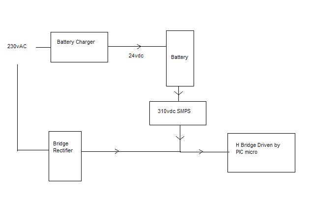

    I want to make a sine wave inverter with 310 vdc H bridge as the final stage driven by signal from sine tabled PWM from PIC microcontroler. can anybody suggest me a cheap and best controller from the pic family.
  8. #208
    Feb 2005
    Kolkata-India
    563
    Default Re: happy u replied!!!!
    A PIC16F616 could be a good choice or even better a PIC16F1824 The later runs at 32MHz has ECCP and supports linear addressing and shadow registers for fast interrupt return.
    Since you would be having a High Voltage DC Bus it is easy to keep it regulated / overcurrent protected and simply drive the output bridge using a micro though a sine table. The only complication could be isolation between the battery boost and the output stage if the same micro is used for housekeeping too.
    P.S. - Personally I would have selected a PIC18F1330.
    Sougata

    With the above diagram. The Bridge Rectifier part from the AC mains turns it into an online UPS and needs to be controlled type for steady DC Bus Voltage. As already mentioned if the DC bus voltage is kept steady the output would also be steady.
    Regarding PICbasic Pro, I learnt everything from this forum and owe all the contributors a lot. Best is take up one programming challenge at a time and get a grip on the concepts involved. This forum is a life-saver. I do not do basic much still while searching information this is the first place I take a peek.
    Good Luck.
    Sougata

  38. #238
    Mar 2008
    25
    Default Re: pic 16f72 based inverter source code
    can you post the aspect of your code that deal with the charging?. here you are talking about syncronouse boost charging when you are using the 2 lower fet to efect the charging. in this case the 6v at the secondary of the same power tansformer is boosted to about 14v to cgarge the battery.note however that at this time of cgarging the upper 2 fets must be switched off then pass you PWModulated signal of a particular duty cycle to drive the lower mosfet. remember equally you are using the leakage inductance of the power transformer for the inductor part of a typical boost converter.
    i hope this help,
    regards,
    babalola.
  39. #239
    Feb 2005
    Kolkata-India
    563
    I feel sorry that I am not being able to support this thread as I should and could not complete the conversion of my SMD design to Hobbyist version. (I wish though) Here are some quick tips that may help you babalola:
    Synchronous Rectification Deals with Switching on the upper FETs on a per cycle,phase basis so that the rectifier efficiency is best while charging, where the Body Diode is superseded by the RDSon of the MOSFET. For the upper one this may sound simple if you are sensing the input AC and know the Transformer connected as ( Primary Start/Finish vs Secondary Start/Finish, My Pro Design detects it) but for the lower one it gets tricky.
    So lets forget Synchronous for now and let the upper MOSFETs behave just like diodes.
    Apply PWM to both the Lower MOSFETs simultaneously but only in the middle of a single cycle, with upper limited duty cycle.
    To experiment what is the limit with your transformer and profile entire system.
    Have a load () connected to the Bridge +DC- and ensure Caps in order of 10000uF
    Run a slow loop to increase the PWM (till you fry your MOS )
    Idea is to figure out if you are actually achieving any boost
    And Tahmid thanks for the great post. I wish I could actually spend sometime giving back to the community for which I am whatever I am today. But I personally would not buy the idea of, a set of different lookup tables for voltage regulation. You can have a 8x8 unsigned multiply within 54uS as stated by Darrel somewhere else and an unrolled Bit tested, rolling multiply takes about 42-44uS to call from PBP. For a proportional control and tricky retention of portion's of older error (I call it pseudo I, cause a software automatically introduces the integration Time) at least a PI system can be designed.
    What I have learned from experience is that sometimes it is the Hardware that is crap than my own code (Loads of Crap ) which is to be blamed. Post a schema if possible.
    Something to read : http://www.researchgate.net/publicat...fe3d4e9275.pdf
    Thanks to all
    Sougata
    Sougata
