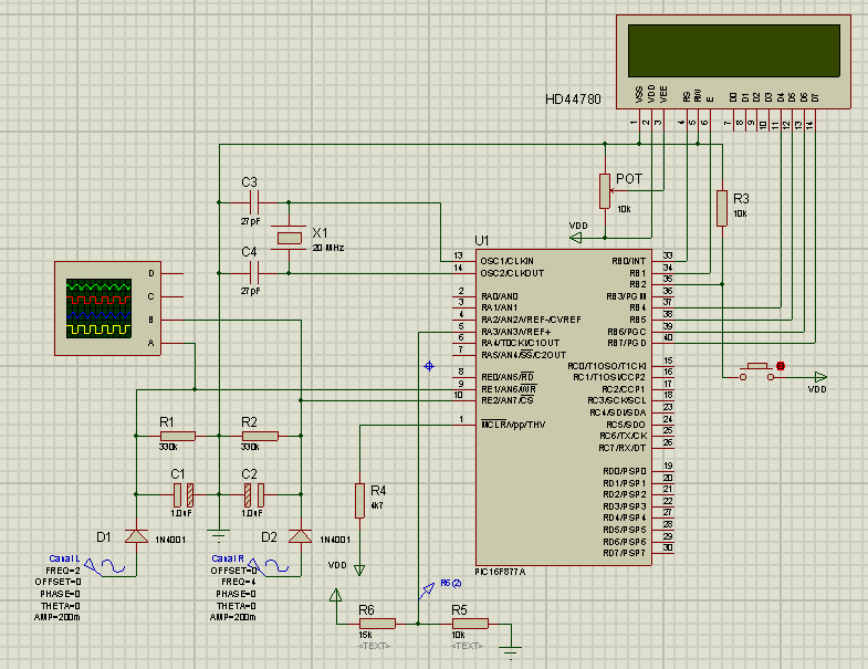

    I am building a VU meter which uses a 16F877A and HD44780. The link below provides both schematic and code in PicBasic (assembler and HEX are also available via a download). The schematic is straight forward and does not deviate from other examples of 16F877A and HD44780 combos. I ran the PicBasic code provided by the author and compiled my own HEX. Original HEX is also available from the author via a download.
    http://www.zaxione.com/in...varias-visualizaciones
    Unfortunately, the LCD is not initializing properly and I have usual 16 block on the top line problem. I wonder if it is a timing problem or perhaps something is missing in the code. Both 16F877A and HD44780 which I am using are working properly in different projects with different HEXs.
    Please let me know what I might be missing here.

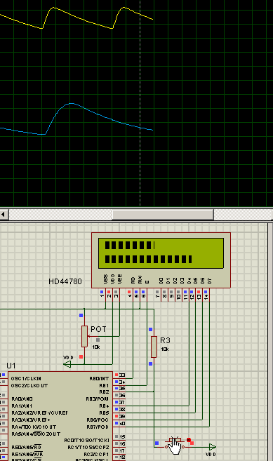

    Prog seems to run just fine in sim. See attached GIF's. First one steps thro all the modes and both traces are 2 volts. Second just a few modes and 1.5 volts. Both show 2 and 4 Hz traces. BTW if you don't specify config fuses most compilers will insert defaults ditto xtal. The fuses for this prog (from Proteus) is 0x3FFB.
    George

    Where are gone the TRISA/TRISB definitions ??? , that between others !!!
    I know most of PBP commands set the I/O's by themselves ... but not all of them !!!

    PS: here, the sim runs fine ...

    1. As I said, 2volts on the first run and 1.5 on the second. 2 and 4 Hz for both.
    2. No components were changed.
    It's a sim so all things are possible. BUT these are very common devices and Proteus will report wrongly configured i/o. eg. using ADC module with i/o set for digital. I agree that the prog gets no style points and relies upon defaults but it does seem to work. Sims tend to fall down with arcane timing issues (race conditions, read modify write etc.)
    With all due deference to the other more PBP savy posters on this thread your problem is most likely physical. Check that you have flashed what you think you have flashed, use the pre-compiled HEX. Check component values and the circuit. Make sure your input is what you think it is.
    For example, does your programmer pick up the config fuses from the HEX file? According to my trusty PicKit2 it should be 2F4D.
    Good luck, George

    Oct 2013
    18
    Default Re: 16F877A and LCD HD44780
    OK, a fixed the problem of the push button acting as a complete reset by adding _LVP_OFF. The damn thing is capricious and unpredictable as weather in May.
    Now, I am back to section 11.2 to implement Archangel's proposal. Maybe it will work on a second run with _LVP_OFF.
    Oct 2013
    18
    Thus far reading section 11.2, I could not understand what is wrong and why the RA3/RA2 arrangement via pot does not work.
    To keep options open I was playing with LM324 arrangement. One issue I cannot figure out. With LM324 inline with the VU meter, without any signal being supplied to the LM324, I have 16 blocks on the top and bottom lines of the display. Once any signal is applied to the LM324, the blocks disappear and the VU meter operates as designed.
    The sensitivity of the VU meter with LM324 is 300 mV full deflection of the VU meter scale on frequency of 1 KHz, or about 30mV per each block of the display.
    Hi epilot,
    you piqued my curiosity re. using vref to offset the ADC. Its limited by the requirment that Vref+ min is 2volts. Using a voltage divider 10k to gnd and 15k to Vdd (5volts). Pin 5 (AN3) goes to the divider. The only software change is to add ADCON1 = %00000001 after ADCON0 is set (note the missing binary sign - by shear luck in this case it works without the %) That gets you 2.5 gain - if my maths is right, which would be unusual because I'm rubbish at maths.
    The other way to get more gain is to multiply CANAL by some constant
    BARRA:
    IF MARCA1 = 1 THEN                            'Si es verdadero
    LINEA = $2
    ADCIN 7, CANAL
    CANAL = CANAL * 4
    MARCA1 = 0                                    '1ºLinea LCD, muestra canal L
    ELSE                                          'Si no lo es
    LINEA = $c0
    ADCIN 6, CANAL
    CANAL = CANAL * 4
    MARCA1 = 1                                    '2ºLinea LCD, muestra canal R
    Now you can adjust the gain on the fly by detecting when it clips and changing constant to a variable. I think I may have suggested in an earlier post that you should divide the ADC output, D'oh (spelling according to Wiki). I think you'll still need some gain on the input.
    Hey, I just realised, the ADC in a 877a is 10 bits but CANAL is only a byte, it's throwing away 2 msb's.
    George
    George
    Oct 2013
    18
    Gerge,
    Thank you.
    As far as your suggestion to modify the ADCON1 goes, I did not understand how the code should look like. Perhaps you could post the entire program with your modifications so I can compile it to a HEX.
    As far as the code which you posted goes, I implemented it in to the original program and compiled it to a HEX. VU meter refused to work with those modifications.

    changes
    1. added "ADCON1 = %00000001"
    2. added "CANAL = CANAL * 4" in two places
    you could also use 10 bit mode
    George
