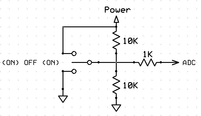

    That will work just fine Tony.
    The one A/D input can be used to monitor and trigger to many levels of the input range within tolerance, but your application is a snap with only three states: Max A/D, Mid A/D and Min A/D.
    Here's an example using a three state momentary switch:
    Just make sure the switching value being monitored will not damage your uC.

    This schematic shows what I think you mean and might work for you.
    The 22K is the recommended value when connected directly to RS232 voltage levels like this. The uC internal protection diodes already clamp the input signal to Vdd so the Zener is a safe option and won't start to conduct until the input approaches the rated value.
    I can't remember my voltage divider formula when it comes to introducing the 12V like this, but the results will be:
    Switch OFF : Vout = 2.5V
    Switch 12V : Vout = Somewhere between 2.5V and 5V
    Switch GND: Vout = Somewhere between 2.5V and GND
    Maybe someone can fling it mathematically or plug the values into their Proteus simulator to help me out.
    As far as the A/D module running in the background. It does, but you still have to start it with some code and I believe the only interrupt indication you get is the ADIF when the read is complete which is pretty fast anyways, in the us.

    Got a hold of a simulator and plugged in the circuit. Actually just drew out the same circuit you had, but I had the input pin at 10K and I have a diode on the 5 V supply line to prevent any back flow if the circuit is ever turned off. With my diode in place and using the 22k resistor, I came out to:
    Switch OFF : Vout = 2.18 V
    Switch 12V : Vout = 4.01 V
    Switch GND: Vout = 1.77 V
