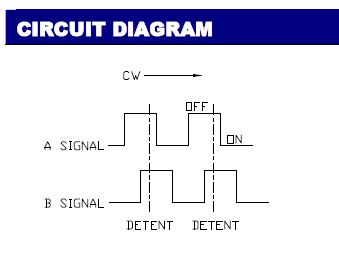

    The two signals are 90 degrees out of phase in relation to each other. This is what it looks like:
    Name:  Encoder output.JPG
    When the encoder is rotating "forward" (ie you're going left to right in the above picture) channel B is low at the rising edge of channel A. When the encoder is rotating "backwards" (ie you're going right to left in the above picture) channel B is high at the rising edge of channel A. So, you need to detect when channel A goes from low to high and then read channel B.
