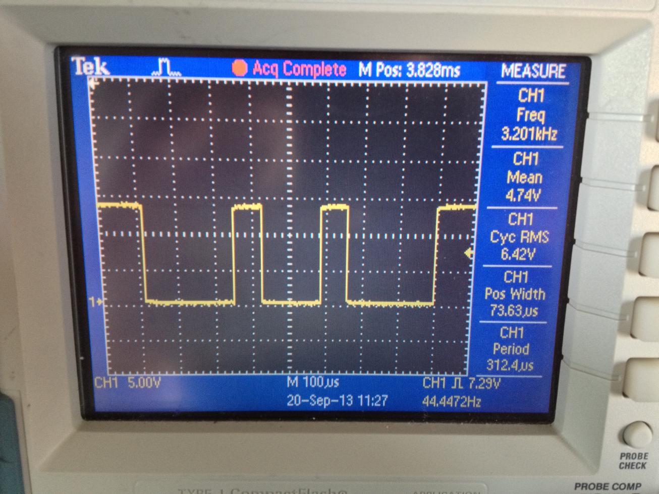

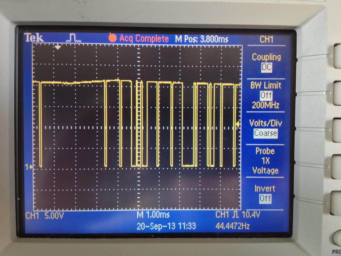

    I'm still kind of lost but seem to be making a little progress. I can see that the entire packet takes 20mS to transmit. It's hard to tell where one piece of data ends and the other begins. I can see the data change when I press buttons on the controller but some of the data isn't used for this application. In other words, those bits/bytes are just taking up space but must be included when the packet is transmitted.
    Perhaps this will help you guys help me. I concentrated on the ones digit for the home team score. I think it takes 750uS to transmit the ones digit and I based that assumption on when the edge falls to when it rises again at the end. However, some of the data takes about 500uS. Is it safe to assume that it takes 750uS for a byte and maybe 500uS for a bit?
    To duplicate the packet (I'm starting with the ones digit), I have the data from the PIC going to the input of a ULN2003A. On the output side I'm using a 10K pullup and then measuring it with the scope. One problem I'm having is that I can't quite get the timing right. I've attached two pictures that show my problem. The first picture is of the source. I'm trying to duplicate what is seen here. In the middle (-250uS from center to +500uS from center) is the number 2. Name:  #2 - Channel 1 (Source).JPG
    Here is my attempt to make the number 2. As you can see, I had to adjust the sec/div to 100uS and the second pulse in the number two isn't the same as the source.Name:  #2 - Channel 2 (PIC).JPG
    Regarding the data being inverted, what is the normal way? High to low or low to high?

    From the images, I do not think it is an UART transmission. Can you zoom out the source capture a little so that you center the '2' and we can see around it a bit more detail?

    Something else popped into my head. The time between the start of each byte is exactly 1,250uS. The time it takes to transmit the total packet is 20mS, which means there are 16 digits. Can I do all of this manually? To be more specific, can I use GOSUB's for each number and just specify exactly how long I need the pulses to be? The data is predictable and I'm not seeing anything that doesn't look strange. There are only numbers transmitted and they are 0-9. My thought is something like this:

    it could be a stream of data for 7 segment display array, that's updated 50 times a second . ie every bit represents a segment
    New Jersey
    425
    Default Re: How to decode communication
    It actually worked! Some of my times are off a bit so the numbers looked a little funny but overall the comms works well. What I also found interesting is that the controller sent the data every 2.5mS but it's not even necessary. I sent it once and the numbers stayed on the scoreboard.
