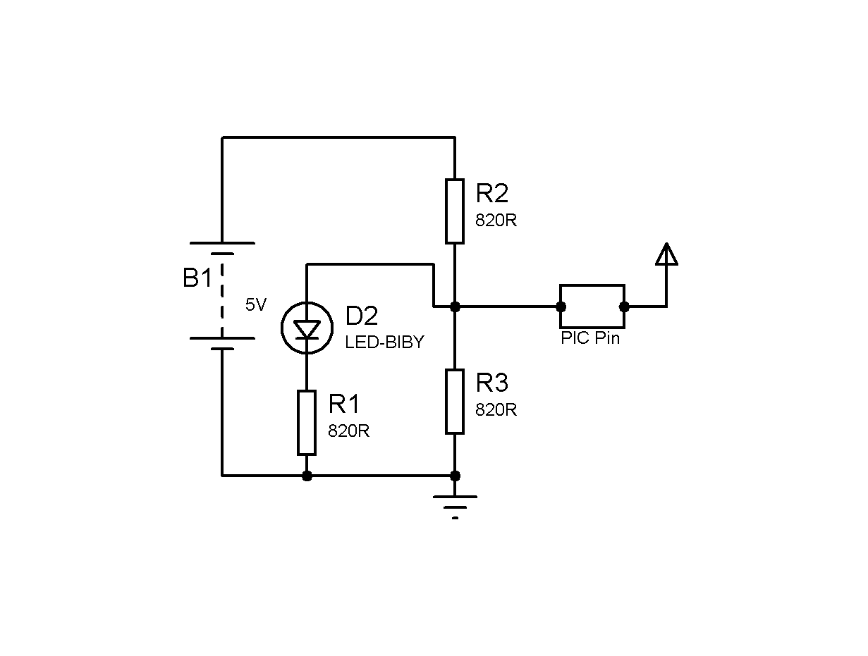

Can you use the same pin as input/output and control led load?

    What are you trying to accomplish with this circuit?
    Is the objective to have the LED on dimly and be able to confirm it has not failed, then be able to have the PIC turn it on brightly or off completely?
    Is the PIC also powered by 5V?
    If so, R3 does not serve any purpose...
