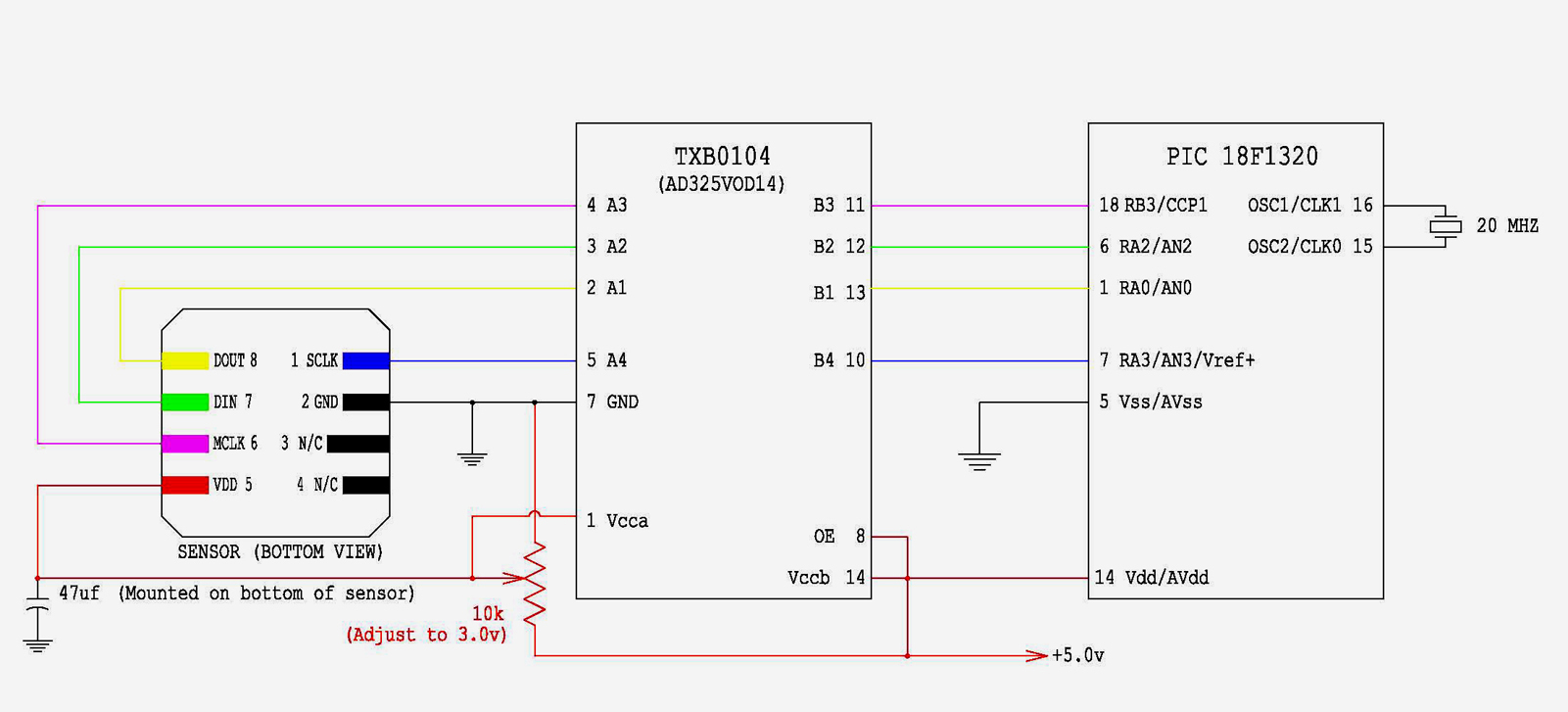

    The sensor is the infamous MS5541-CM and I believe the protocol is SPI. Basically the sensor to a 3v to 5v converter to the PIC then from the PIC to a MAX232-cpe to the computer. At short distances from the 3-5v converter the sensor readings are "normal", that is you will accurately read room temperature for example. As the cable from the 3-5v converter becomes longer the room temperature reading becomes abnormal such as -1434C. First cable was a shielded 6-wire, 22 gauge cable. Then I tried a ribbon cable with signals on every other wire with ground at one end only for the wires inbetween the signal wires to avoid cross talk and any ground loops.
    Best, Ed

    1) The sensor needs an external clock of 32.768kHz (typically), how are you feeding it that clock signal? Thru the same cable?
    2) The maximum SPI clock frequency (not the same as above) is 500kHz, what frequency are you using and are you using the MSSP module in the PIC or SHIFTIN/SHIFTOUT?
    Again, a diagram showing what you have and exactly how it's connected really does make it a lot easier when trying to help. What's that 3-5V converter for example?

    Sometimes that 3v/5v converter for the communication lines are not needed. Are you converting the SPI lines to 3v going into the sensor? For a long cable there are already losses. Try your setup without the DC/ DC converter.

    Basically the sensor goes into a TXB0104 at 3v and from the TXB0104 at 5v into the PIC. I have been trying to extend the 5v side from the TXB0104 to/from the PIC with Shiftin and Shiftout. This has clearly been a problem for others after several hours of searching the internet and no one seems to have published a solution. From the PIC 18F1320 through a MAX232CPE into Com1 using the ICD in PicBasic Pro you can see all the readings. While very difficult to do I did manage to place a 47mfd tant. cap to the back of the sensor so it could not be any closer/shorter! Attached is the drawing. Ed

    Personally I would not trust the 3.3V power supply setup you've got going there. The current consumption of both the sensor and the "A-side" of the TXB0104 will most likely not be constant meaning the voltage drop across that resistive divider will change resulting in an unstable 3.3V supply rail. Now, the cap you fitted obviously will help but I still don't think it's good solution. I'm not saying it will fix your issue but I would at least try with a proper 3.3V supply for the sensor and the A-side of the TXB0104 - at least to rule it out.
    Also, make sure you have a decoupling capacitor on the VccB pin of the TXB0104. As you extend the cable length the capacitance of the cable increases, that capacitance will need to be charged and discharged by the driver circuitry in the TXP0104. It'll need proper decoupling.
    Are you generating the 32.768Hz clock for the sensor with the CCP module in the PIC?

    Parallel a 0.1uF capacitor across the 47uF. Whilst the 10k pot to derive the 3V supply is very crude you show no decoupling of the 5V supply itself or the attached ICs - all of which are required.
    The data lines to the PIC should be via twisted pair and, if necessary, decoupled to ground themselves.

    Thanks and I actully did place some .1 caps across the 3v and 5v side. Just added a 100mfd to both the 3v and 5v side of the TXB0104. How things are built is there is a small proto board about 4" from the pic which has the TXB0101. Then the sensor connects to the same board. I would love to be able to add a .1 on the back side of the sensor with the 47mfd cap. and just connecting what I have connected has been a real challenge. Damn stuffs too small! Lol Best, Ed
    Good advice on decoupling 5V, but not good advice about adding 0.1 uF across the 47 uF. In some instances, for example using a large electrolytic capacitor with high ESR/ESL this could help with high frequency noise, however tantalum devices are likely as good as the ceramic in this case, so this will not do anything useful and will drive you crazy trying to solder it on. Worse, in some cases, you could introduce instability with a second pole in the filter, so this approach should be used with caution. And adding caps to the data lines will reduce the range and degrade the signal - very bad idea. Also twisted pair will be more harmful than helpful in this instance, since the signal is unbalanced.
    Honestly, the problem is most likely the poor 3V supply - fix that before investing any time in other approaches.

    In your case I'd keep the GND connection as short as possible, the connection to the positive rail then becomes whatever length is required. Then place the decoupling capacitor right across the supply pins of the device or as close to the supply pins as you possible can.

    Thanks! One idea was to use 18ga buss wire for ground while 22ga for power. If I understand correctly then the negatives leads of the capacitors would be short and the positives would be long? Wouldn't this be allowing any spikes or signals to be on the positive supply rail? Thanks, Ed

    Just an update. After rebooting my computer things settled down and became more reasonable. I did some intense research and it turns out the TXB0104 does not like a capacitance load on any of the output or input pins of more than 70nf! So while twisting the wires seemed like a good idea (suspecting noise) it just made everything worse! I cannot believe they would make a device with such limits! Also I got my 3.0v regulator and things again look good. Thanks. Best, Ed

    1) There is no way you are getting more than 70 nF capacitance from twisting a few inches of wire. Not even 70 pF. 70 nF is HUGE!
    2) All signal pins on all devices will have some value of capacitance that renders them inoperable. The value at which things fall over is usually related to the signalling speed, and sometimes related to the driver design.
    3) Power pins are not signal pins. They need capacitors.
    4) If rebooting your computer addressed the problem, then your circuit was fine all along. But it's hard to see how it could have had any impact at all. Very unusual. I think there's still "some 'splaining to do"...
