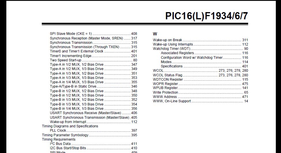

    Your useing a 1936 chip, really too old. How about upgrading it to a 2013 one!

    As far as post 3, I double checked the datasheet and I didn't see anywhere that it was originally designed for the W.O.P.R. computer, so I figured I was good

    Doh, I spoke too soon! I can't believe I missed the WOPR Register

    I don't follw you on the WOPR register buy anyway

    I see the further refinement now. BTW, the WOPR is in reference to the awesome computer in war games :-)
