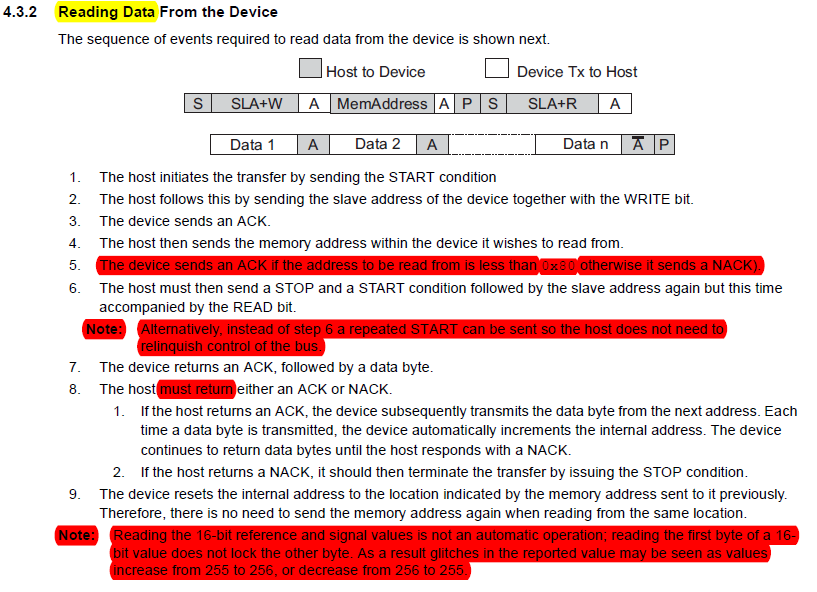

    I attach the section explaining the I2C from the datasheet. The device address is $1B.

    What is also confusing me is the control byte in the manual, the device datasheet does not mention any control byte.
    I have an address $1B which I am sending as control and location in the device is being sent as Address according to the manual.

    I couldn't find detailed info on the Write/Read bit of the device address. But I will guess it is bit 7.
    You need to Write to the device first using the address with the "Write" bit set.
    $1B or %00011011 becomes $9B or $10011011
    Without confirming the proper syntax of the commands, here's something off the top of my noodle:
    This will cover steps 1~4 of Section 4.3.2 of the datasheet
    I2CWRITE SDA,SCL,[Addr,Loc,]  ' Addr plus Write bit = $9B
    This will cover steps 5~7 of Section 4.3.2 of the datasheet
    I2CREAD SDA,SCL,[Addr,Loc]   ' Addr plus Read bit = $1B
    Putting it together should get you moving in the right direction.

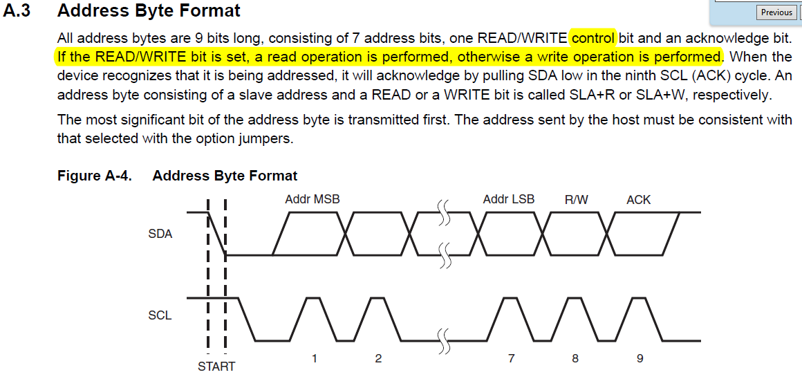

    I read it again to confirm this, the attachment is my source. It also mentions 9 bits long address. Not sure who sends an ack. I see that in read statement the device send ack, so why add it to the address PIC is sending. Very confusing.

    Default Re: I2C CONFUSION, Help needed please
    Ahhhh... okay
    Let's use this info then. Looks like the address is using bits 1~7 and the Read/Write control bit is 0.
    If control bit is set (=1) then Read, if bit cleared (=0) then Write
    So:
    %00110111 = $37 ' Read function
    %00110110 = $36 ' Write function
    Try that.
    By the way, the device sends the ACK, or acknowledges, by holding the Data line LOW on the 9th clock cycle. The PIC will see this and continue to send data.
    Quote Originally Posted by LinkMTech View Post
    I would have thought:
    %00000001 = $37 ' Read function
    %00000000 = $36 ' Write function
    I don't see in this datasheet where you get the rest.

    I just discovered, that the I am actually receiving only 1 byte as expected. Rest are just "Start......"13,10 and "Done",13,10. Yesterday got too exhausted and missed this mistake of mine.
    Here is the current code with

    Every time Change line goes low (detected something), I try to read first 4 memory locations. The communication fails a lot of times (both write and read (write more than read) )in this attempt but I do get the data on the screen finally. Secondly, the data which comes is wrong. For example, memory locations 0 does not read 2E for a start.
