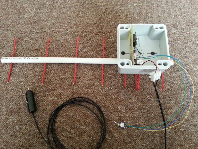

    Pictures of the prototypes. The 9db gain yagi aerial is made from oval plastic electrical conduit using UK 2.5mm twin and earth wire for the elements.
    The coax and super mini plugs were from a junk laptop wifi aerial. It's the grey lead on the loop aerial on the 'receive' board.
    The pic controller is in the box at the moment with the switch showing, the leds are on board for now. The switch and leds need to be in a desktop box with the pic and the radio module left in the box with the aerial. Nothing is yet sealed, it will be later with a hot glue gun.
    I've made the pcb's with a set of pads on the connecting tracks so that the boards can be cut and wire used to connect. They can be just made out on 'receive' board.
    The red led on the 'receive' board is a 'heartbeat' led that confirms radio module operating.

    The loop is a 3db gain Moxon rectangle.

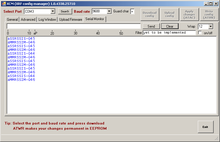

    Software for signal strength for setup of yagis is in progress. This is what I have so far in progress and have posted a question re syntax in Ciseco forum.
    I need to work out the lowest values for sigfield/sigcontrol variables , highest value (lowest signal) is around 88-90 as a returned value. Then send to lcd display.
    rssion:
        SEROUT2 PortA.3,84,["BOB",sigon]    ; puts slave module in test mode via code
        PAUSE 1000                                    ; wait 1 second
        SEROUT2 PortA.3,84,["+++"]           ; send guard character
        SEROUT2 PortA.3,84,["ATNT3"]         ; place unit in test mode
        SEROUT2 PortA.3,84,["ATWR"]          ; write to memory
        SEROUT2 PortA.3,84,["ATDN"]          ; exit command mode
    sigstrength:
        SERIN2 PortA.2,84,1000,sigstrength,[WAIT("aSSRSSIS-",sigfield)]       ; get slave sig strength value
        SERIN2 PortA.2,84,1000,sigstrength,[WAIT("aMMRSSIM-",sigcontrol)]  ; get control sig strength value
        IF jump = 0 then rssioff                                                                     ; check input to reset to serial
        GOTO sigstrength
    rssioff:
        SEROUT2 PortA.3,84,["ATNT0"]          ; place unit in serial mode
        GOTO main

    Not having any success getting the modules into test mode using the AT commands as per the code.
    I'm saying this because the routine stops waiting for a signal strength report which isn't there. This means the routine to put it into test mode isn't working.
    Anyone any suggestions ?
    4,170
    Default Re: Serin Serout possible wiring distance
    Can you post your code please?

    THIS IS FROM THEIR SETUP RSSI INFO PAGE
    The AT commands are in the brakets at the side. Compare to my code.
    In order to test the range between two devices, it is possible to put two XRF's into a special mode via either the AT commands or the XCM. Once in the special mode it will send a packet once a second from an XRF connected to your PC (master) to another 'remote' (slave) XRF. The slave XRF will measure the incoming RSSI level and send the packet straight back. The master XRF then measures the RSSI of this and displays both packets serially.
    The image below shows the continuous output you will see on your screen. We're interested in the first two values:
    aSSRSSIS-045 (the signal strength of 045) received at the slave and
    aMMRSSIM (046) received at the master (your PC).

    OK don't know why I didn't think of it before, I used my scope on the TX RX pins when both units are in test mode.
    They have data back and forth at 1 second intervals. That means they are transmitting and receiving.
    So, it's down to this routine not working. Given the details above I just can't see why :-

    Yes yes yes, finally !
    This is what was required to make it work.
    sigstrength:
        IF jump = 1 THEN rssioff     ; check input to reset to serial
        DEBUGIN  1500,sigstrength,[WAIT("aSSRSSIS-"),DEC3 sigfield, DEC3 sigcontrol]    ; get signal strength values
        LCDOUT  $FE,$80," Light Unit ",#sigfield
        LCDOUT  $FE,$C0," Control Unit ",#sigcontrol
        GOTO sigstrength
    Note change(s). Apparently the photo of the display in RSSI is parsed by the software to separate lines. In reality it's a single stream of both items per second. The LCDOUT needed # for ASCII.
