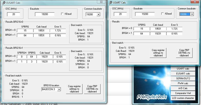

    Default Re: USART Settings request. My PICMulti-Calc is not working
    You mean like this?
    Louie
    Thanks Louie. Could you please paste the settings here for the USART which I can copy into my code.
    Oops, I knew I forgot something...
    '   Mister E PIC multi-calc "USART calc"
    '   OSC = 20MHz
    '   Baudrate = 19200
    RCSTA = $90 ' Enable serial port & continuous receive
    TXSTA = $24 ' Enable transmit, BRGH = 1
    SPBRG = 64  ' 19200 Baud @ 20MHz, 0.16%
    DEFINE HSER_SPBRG 64  ' 19200 Baud @ 20MHz, 0.16%
    Louie
