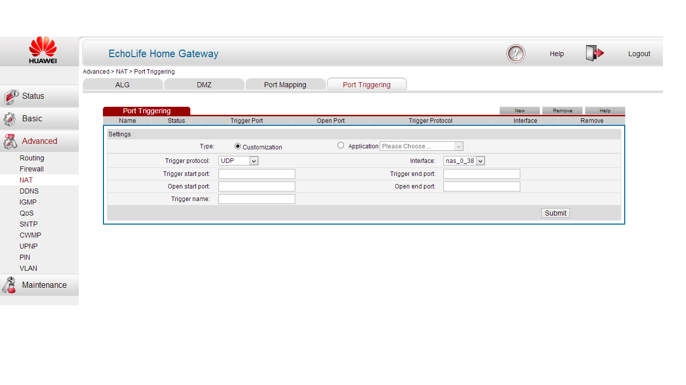

    Thanks Don. 1 problem, I can't find the port forwarding option. I have taken a screenshot of (what I think is) the closest option. Please guide me through this. ThanksName:  1.png

    I saw some videos on your tube and found out how it is done. But before I start making changes to the router I would like to confirm
    1) If the information (based on my understanding) in the attached picture is correct?
    2) If yes then: Would it be correct to enter the external port 30000 and internal port 25000? (I just chose these ports randomly)
    3) If Yes then: Should I start listening to the 25000 port number at my laptop? As any data sent to the external IP of my router at port number 30000 should arrive at port 25000 of my laptop (provided I enter my laptop's IP in internal host (eg 192.168......) ?
    I am just a little worried about messing something up as I do not have any knowledge about this. All help is appreciated. Thanks

    I tried the above settings. This is what I did:
    1) Wrote IPconfig on the command window and got my laptop's internal IP-->> Inserted it at 'internal host'
    2) Chose a random port 5579 (external) & 2500 (internal)
    3) Chose protocol TCP/UDP
    ------SAVED THE SETTINGS SUCCESSFULLY ------
    Got my iPad, downloaded an app where if you supply ip and port, it sends a UDP packet to that address at that port. Ran the NETAssist software on laptop, chose UDP data, and started monitoring port 2500 at my laptops ip address.
    App tried to send data to my routers external IP which I got from google by typing 'my ip' at port 5579.
    ----RESULT: NOTHING SHOWED AT Net Assist software------
    Tried the same with TCP settings instead of UDP. Still nothing.
    Tried making both the ports same (internal/external) still nothing.
    What can I try next?
