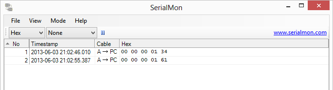

    Ok, here is the update. The serialMon pic is attached. The first HEX code is when I receive a '4' and the second is when I receive 'a'.
    I tried modifying the code and a few versions of it actually, but nothing worked. How do I capture the value coming as in the pic attached.

    34 is the ASCII code (in HEX) for '4' and 61 is the ASCII code (in HEX) for 'a' so the actual data you want to capture is the fifth byte in the received packet. How about
    DEBUGIN[WAIT (1), B0]    ' Wait for the 01 part of the string then grab the next byte
    or
    DEBUGIN[SKIP 4, B0]    ' Skip the first four bytes, grab the fifth.
    EDIT: Or, if it's actually the 01 part you want to capture (and it's NOT the ASCII code for the digit 1 by the way) then perhaps DEBUGIN[SKIP 3, B0]
    or
    JOB DONE! Cheers for the help
