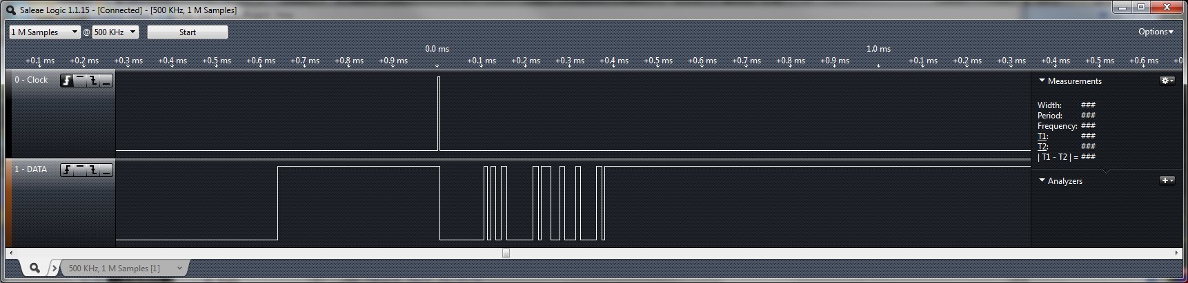

    I still can't get the I2CRead/Write to work with this EEPROM and I have used them with other PICs in the past with no problems. I used my Logic Analyzer to capture both the Shiftin/out and the I2CRead/Write examples. I could follow the working Shiftin/out on the Logic analyzer, but the I2C is either faster than I can capture, or completely messed up. I am using the same program to test both routines.
    I just tried uploading the analyzer screenshots, but it said I didn't have permissions.

    The analyzer shows the I2C commands to be much faster. Maybe the EEPROM is too slow?

    Trying again to upload the analyzer screenshots:
    I2cWrite:
    Name:  I2CWrite Letter A to EEPROM.jpg
    Shiftout (Works):
    Name:  Shiftout Save Letter A to EEPROM.jpg

    You don't mention the osc speed. The manual mentions up to 20MHz, the 18Fs can go much faster.
    Odd that your clock is whacked. What about pull-ups on your pins?

    I bet it's that there are no pullup resistors on the SCL and SDA lines when using I2C command. The SHIFTOUT and SHIFTIN command use the pins in a sink and source mode but the I2C mode reverses the the data pin direction at the end of the byte sequence looking for the ACK bit from the slave device. There must be a pullup on the data line to provide sourcing current back to the PIC. If the PIC does not see the proper ACK signal then the command sequence is aborted.

    I am running at 16MHz with the Internal OSC. I do have a 10k pullup on the SDA line. I tried a 2k as well and it did the same thing. I don't have any pullups on the SCL line now, but I did try that before with no luck. I will try it again. I may drop a 16f690 in for testing purposes (Pin compatable with the 18f14k22 and I know they work with this EEPROM).

    I am running the Internal OSC at 16MHz. I did try slowing the clock down and it still didn't work. I am not sure if the Clock is whacked or if my Logic Analyzer is just too slow to capture it (500kHz is as fast as it will run on my computer for some reason).

    Also a MAXIMUM resistance on each SCL and SDA lines to VCC of 2.2k. The faster the bus speed the smaller the resistance.

    Problem solved! I added the 10k pull-up resistor to the SCL line as you suggested and everything started working. I did have a 10k on both the SCL and SDA lines originally, but at that time I must have had something else wrong. I checked the datasheet which only stated pullup of 2k-10k on the SDA line so I removed the SCL pull-up and never put it back. I was able to fully load the EEPROM and now I can read an entire string from EEPROM at a time (Much better than the ShiftIn/Out way). I guess since the Shiftin/out was working I assumed the electronics was correct. I have used these EEPROMS in the past and never had an issue. I guess I should have looked at my old schematics before pointing the finger at Pic Basic!
