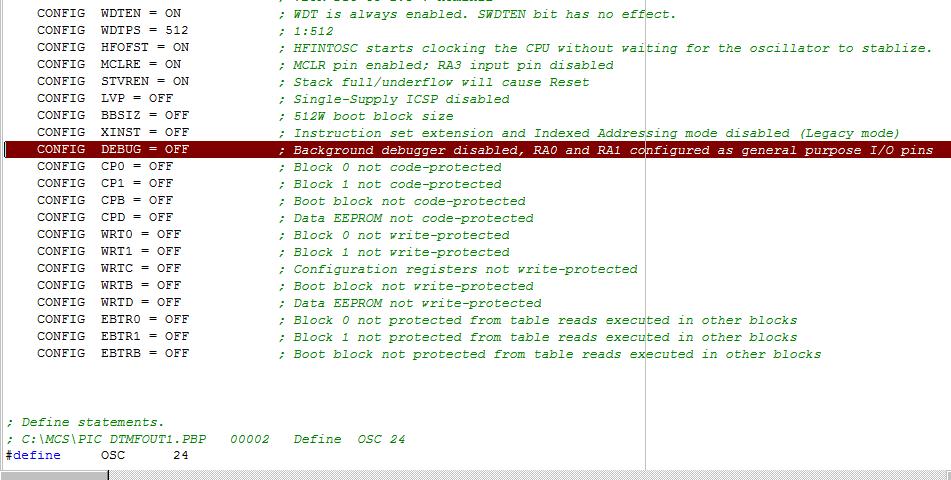

    I've recently upgraded my PBP from 2.6 to 3 but I often receive error messages in the compile process that I didn't previously receive with the same code like:
    [ASM ERROR] My_Program.ASM (48) : CONFIG Directive Error: (setting "DEBUG" not found for the processor 18F13K50)
    Is this because I haven't updated something I should have during the process?

    Are you referring to the #CONFIG marker to specify an assembly language block as mentioned in the migration notes? I've read through the migration notes reasonably thoroughly and I can't recall it mentioning "config" being used for anything else? To me, the error doesn't appear to be pointing any fingers at "Config" directly, but more to an omission in one of the support files?

    BTW: This is the screen grab I get when I click on the Error Message:
