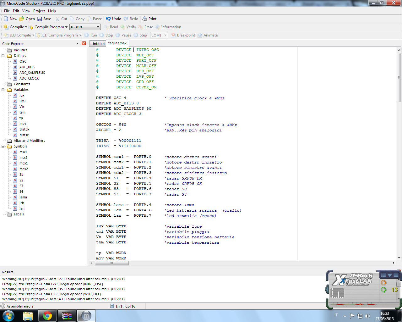

    how can I set this things with microcode studio on PIC16f819?
    @ DEVICE INTRC_OSC
    @ DEVICE WDT_OFF
    @ DEVICE PWRT_OFF
    @ DEVICE MCLR_OFF
    @ DEVICE BOD_OFF
    @ DEVICE LVP_OFF
    @ DEVICE CPD_OFF
    @ DEVICE CCPMX_ON
    I can't find the section for configuration bits on the program

    Yes, of course and in the previous post you can look at my needed configuration.
    Unfortunately the microcode studio sais that it is incorrect
    8
    Default Re: Set configuration bits
    As you can see there

    What version of PBP are you using? And, which assembler is MCS using?
    In PBP3, the config settings would be something like:
      __config _INTRC_IO & _WDT_OFF & _PWRTE_OFF & _MCLR_OFF & _BODEN_OFF & _LVP_OFF & _CPD_OFF & _CCP1_RB3
