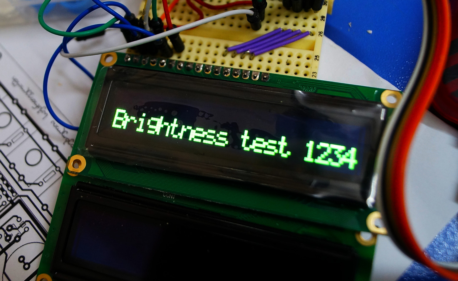

    This is amazingly fast OLED with WS0010 controller - it has switchable fonts, etc. all work just fine

    As I've said, I've obtained this brightness control via "let's send incremental sequence of bytes and watch what will happen?" btw, this module says it uses WS0010 compatible controller, which does not means it uses exactly same controller. By the way, why you just not simply try to send incremental bits to controller? maybe this is an undocumented feature?
    Here's small video, showing brightness change.

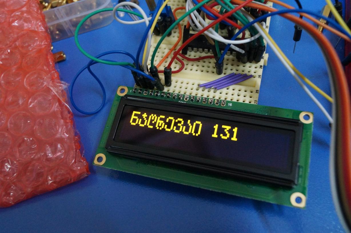

    Yes in graphic mode it is possible. Even now with this one I can control it, just there is no physical pixel
    Here is the picture. Too bad, they are not making standard LCD's with that WS0010 controller, it would be mega practical

    My "gapless" 1602 OLED finally arrived, and it is finally gapless - now letters in text mode have no more spacing between each other, so they overlap. Have no idea how to fix this. Btw, module is 20 character per line, not 16, but has exact same dimensions as 1602 modules.
