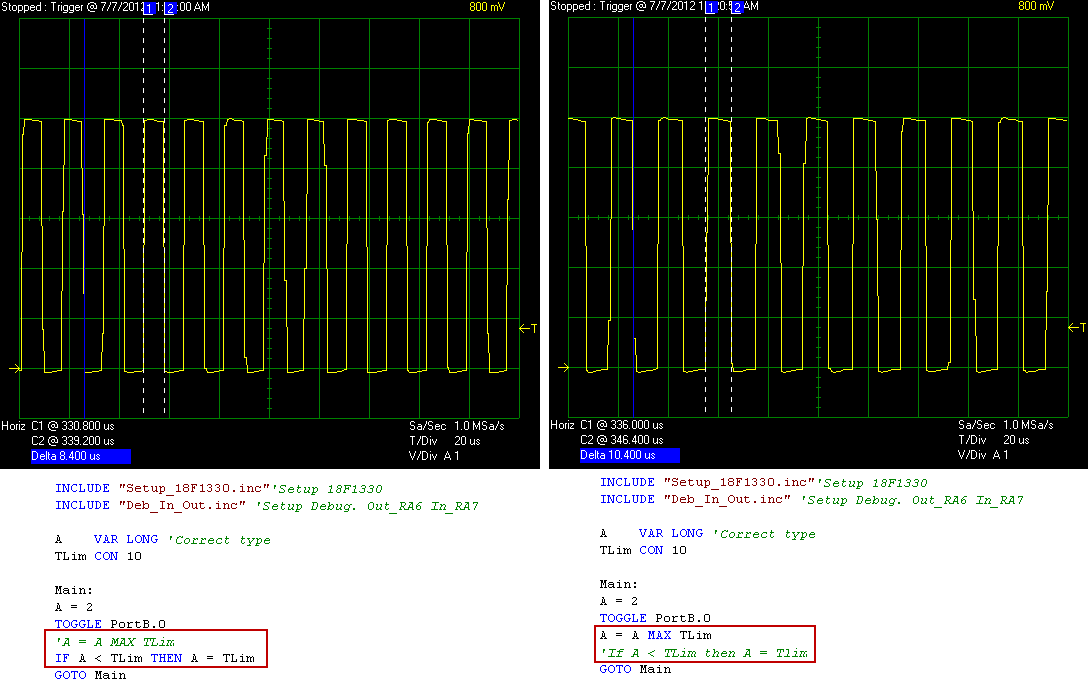

    I had couple of minutes to investigate the MAX and MIN and ways around them as the syntax seems upside down TO ME. Here is the result.
    I know it isn't much of a difference but why use something that is less clear and less efficient?

    Just understand it as MIN or MAX of the two values ...
    BTW ... your use here seems a bit strange ... @ the speed you run Why not make use of a Hardware comparator or an ADC measure ???
    the 1.5v trip limit of the inputs is ... not so precise ( absolute value ) ... especially if some capacitive circuitry around ... added to the high slew-rate of your signals, the result is quite predictable ...
    The difference in time you see is due to the different working values comparing macros ... just have a look to the produced .asm, and you'll understand that ...
    AND .. YES, MIN and MAX commands are slower than IF-THEN ...
