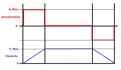

    My aproach, as it currently stands is based on around a basic state machine with four states - Stopped, accelerating, traversing, decelerating. Timing is very consistent, being interrupt driven, calls to the PID routine is currently at 1000-2500Hz (user selectable) but I think I need to allow a divisor between it and the profile generator.Basically, here's how it works:
    I've got:
    [Desired velocity] <- Set by user
    [Desired position] <- Set by user
    [Desired acceleration] <- Set by user
    [Output velocity]
    [Output position]
    [Output acceleration]
    On the very first call to the state machine when a new move is about to begin variables are initialized and [Desired position] is recalculated into a relative distance from the current position of the motor.
    In the acceleration state [Output velocity] is increased by [Desired acceleration]. Then [Output position] is increased or decreased by [Output velocity].
    If [Output velocity] is equal to or larger than [Desired velocity] it's clamped (before manipulating [Output position] ), the traveled distance is stored and the state is changed to traversing.
    If [Output position] is equal to or larger than [Desired position] / 2 the state is changed to decelerate.
    In the traversing state [Output position] is increased or decreased by the set velocity. If the output position is equal to or less than [Desired position] - "distance traveled during acceleration" state is changed to decelerate.
    In the deceleration state the [Output acceleration] is recalculated each tick based on [Output acceleration] = [Output velocity] ^ 2 / 2d where d is the distance left to target. [Output acceleration] is subtracted from [Output velocity] which is added to or subtracted from [Output position].
    Now, this will, most of the time, violate [Desired acceleration] when decelerating which I initially said was unacceptable. However, given the fact that the motor position is commanded and sampled at discrete time intervals and is allowed to move an arbitrary amount of counts (any velocity) I simple can't see a way to make it accelerate/decelerate with set rate, run at speed and end up at exactly the desired position - all at once. It's not perfect but just like timmers said early on the deceleration will likely be stretched out over hundreds or even thousands of ticks so in real life it might not even be noticable.
