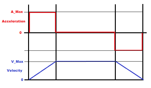

    I'm looking for help and advice on implementing a basic motion profile generator in PBP. Ideal would be 3rd order one (linear acceleration, S-curved velocity) but the simpler 2nd order (trapezoidal acceleration, triangular velocity) proved to be hard enough to get right so I'll settle for that to begin with. Here's a crude drawing illustrating what that type of motion profile looks like:
    I'm trying to base my version on Microchips AN532, the profile generator is covered in detail in appendix E. But I'm obviously running into trouble or I wouldn't be here seeking advise.
    Without looking at any code lets just look at the theory.
    • I have a timer interrupt running, providing a system tick (the frequency doesn't matter here)
    • I have a Position variable which tells the feedback loop where the motor is supposed to be at any given time. The feedback loop plays no actual role here.
    • I have a Target variable which is to where I want the motor to move.
    • I have an acceleration value (A_Max in the above drawing), lets say this value is 10
    • I have a Velocity value which is the desired motor velocity in encoder counts per system tick at any given time.
    • I have a max velocity (V_Max in the above drawing) which is the velocity at which I want the motor to move. Lets say this value is 100
    Now lets look at how easy it is to ramp up or down the motor speed. Initially Velocity is 0:
    Each tick the value of A_Max gets added to the value Velocity. If Velocity > V_Max THEN Velocity = V_Max. The value of Velocity is added to the Position variable.
    This will ramp up the motor from 0 to V_Max and then keep it running at that velocity. Ramping it down is obviosuly equally simple, just subtract A_Max from Velocity and Velocity from Position until Velocity is 0.
    What I'm struggling with is to make it stop at the Target position.
    In the Microchip implementation they begin by dividing the total distance of the move by 2 and store that value. Then they start to accelerate the motor. Now one of two things can happen:
    1) Half the distance is covered before reaching V_Max in which case the motor is decelerated.
    2) The velocity reaches and possibly gets clamped at V_Max before half of the distance is covered.
    In (2) above they count how many ticks the velocity is at V_Max and when half the distance is covered they start subtracting from that count, one tick at the time. When the count is 0 they decelerate the motor. Pretty simple.
    If we do a move of 2000 with A_Max=10 and V_Max=100 then it would look something like this:

    Perfect! This works because everything is dividing nicely into everything else. But what happens when, for example, A_Max doesn't divide evenly into V_Max?

    Here we end up 100 counts short of the target. I understand WHY it's happening but I can't seem to figure out a good fix for it.
    In the Microchip application note they seem to somehow determine which is resulting in the smallest error, one more or one less "tick" at V_Max. They then, obviously, opt for the one resulting in the least amount of error at the end of the profile and then they're simply "bumping" the motor to the CORRECT target position at the end of the move.
    I really can't have that - I need it to ramp down and end up exactly AT the target position.
    If anyone's got any ideas, pointers, suggestions or codesnippets I'd really appreciate the input, thanks!

    And I need to make it go both directions, it only goes forward right now.
    I hope to have something by the time you wake up in the morning.
    Sometimes being on the other side of the planet is helpful.
    3,624
    Default Re: Motion profile generator.
    Thanks Darrel!
    Actually, I don't think you should need to worry about the direction. Perhaps I misunderstood your earlier question and overcomplicated my explaination after all.
    How about this:
    * The "global position variable" is the expected motor position at any given time. The PID loop servos the motor to this position.
    * The "relative position variable" is the output of the profile generator, exactly as you shown earlier, always starting a new move at 0.
    * When a new move is commanded it is easy to calculate if the target position is positive or negative relative to the current "global position".
    * A profile, starting at 0 and ending at ABS(Target Position - Global Position) is then generated.
    * Depending on the direction or "polarity" the output of the profile generator is added or subtracted from the Global Position variable one "tick" at a time.
    * The PID loop makes the motor follow the Global Position variable very smoothly and everyone's happy, especially me :-)
    Does that make sense?
    EDIT: Put another way... Acceleration is added to Velocity. Velocity is added to RelativePosition. RelativePosition is added to OR subtracted from GlobalPosition.
    H,
    Ditto on you always helping everyone. If this isn't too elementary relating to where your at.......
    on de-celleration when V_Max reaches to 0...zero, recalculate the ACC (will be de-celerate) val.
    if you want the same amount of iterations to de-cel as used to acelerate, at A=10 then 100/10 for 10 loops or A=15 for 100/15 for 6? or 7? loops..............
    then subtract present pos (@ V_MAX=0) from desired pos. Thats the actual steps to stopping ??
    now use sum of # loops...( sum=loops(loops+1)/2) is new ACC val to loop to 0 (zero) over that many loops (should be +- 1 or 2 from the starting ACC val)
    now there will be either 0 or some amount less than A as a final step to stop.
    should be a few more lines of code to test and calc.
    I think Darrel mentioned re-calc something.
    don
    Maaaannnnn ... This is harder than it looks.
    Well, I have it going to the exact target position with zero error ... as long as it's able to reach the maximum velocity (the flat part of the profile).
    But if the target position isn't far enough away, and it doesn't reach V_Max before it has to decelerate ... it overshoots the center, and with the maximum deceleration (A_Max) ... the velocity can't reach 0 until it's past the target. Arrrrrggg.
    So on the shorter distances, I'll have to stop accelerating before it gets half way there, and calculate a new slope for the second half so that it stays under the maximum deceleration and gets the velocity to 0 before or at the target position. This way will make it decelerate slightly slower than it accelerates. Probably not noticable though.
    Need more time.
    3,624
    Darrel,
    What, you need more time? Unacceptable, I need a working solution NOW ;-)
    Seriously, take all the time you need, I appreciate any and all help!
    I know, I found it quite a bit harder....
    Since I don't know how you're actually aproaching this I'm just thinking out loud:
    On the short moves I'm thinking how it would work out if the distance was simply cut in half and then the actual acceleration value tweaked to fit so we'd hit right on the centermark while accelerating. Then start decelerating at the same slope would make us end up at the target, right? I wonder what the worst case deviation from the set acceleration value would be... Code size and speed is obviosuly of interest as well...
    I'm looking forward to see what you come up with!

    Here's what I'm up against ...
    You can only adjust the acceleration.
    I don't see any way to know what acceleration is required to make the half-way point end up exactly at an interrupt period.
    It always ends up somewhere in the middle of a period.
    If I new what the velocity would be at the halfway point, I could adjust the acceleration so it reaches the half-way point at exactly an interrupt period.
    Except that since the acceleration changed, it won't be at that velocity at the half-way point anymore.
    So I don't see any way of predicting the half-way point in order to use the same deceleration slope it uses for acceleration (the yellow line).
    I can only change the acceleration at specific times, which coincide with the interrupt periods.
    So if I recalculate the deceleration slope at period 6 before it reaches the half-way point, it creates the green line, which should end up at the target perfectly.
    If I were to recalculate it after passing the half-way point, the deceleration rate would be higher, and violate the A_Max constraint.
    The blue line is the overshooting profile, with it's velocity using the left axis.
    The red line is the position, using the right axis.
    The parameters for that run were ... A_Max=10, V_Max=100, Target=475.
    I'm doing the green line.
    But since the green line is actually a slower velocity, it will take longer than shown in the chart to reach the target.
    But at least it is calculatable.

    Ok Henrik, here's what I came up with.
    To start a movement, set the three variables and call the ProfileStart subroutine.
    MaxAcceleration = 10     ; starting values
    MaxVelocity     = 100
    TargetPosition  = 2000
    GOSUB ProfileStart
    Then for each period, call the ProfileStep subroutine, and the variables ... ThisAccel, Velocity and Position will be updated.
    When the TargetPosition has been reached, the ProfileComplete flag will be set.
    For the above values, the output of the test program looks like this ...
    Like your original example, the first column is Acceleration change, second column Velocity, third column Position.
    1 = Edit MaxAcceleration (10)
    2 = Edit MaxVelocity     (100)
    3 = Edit TargetPosition  (2000)
    Enter = GO
       0       0       0
      10      10      10
      10      20      30
      10      30      60
      10      40     100
      10      50     150
      10      60     210
      10      70     280
      10      80     360
      10      90     450
      10     100     550
       0     100     650
       0     100     750
       0     100     850
       0     100     950
       0     100    1050
       0     100    1150
       0     100    1250
       0     100    1350
       0     100    1450
       0     100    1550
     -10      90    1640
     -10      80    1720
     -10      70    1790
     -10      60    1850
     -10      50    1900
     -10      40    1940
     -10      30    1970
     -10      20    1990
     -10      10    2000
     -10       0    2000
    Enter = GO
    I quickly tried the "Ease From" and "Ease To", but it messed up the final position so i pulled it back out.
    I'll have to think about it some more.
    The MaxAcceleration variable will get changed on small moves.
    So you should keep a separate variable and copy it to MaxAcceleration before starting a profile.
    Hopefully, this is somewhere close to what you were looking for.
