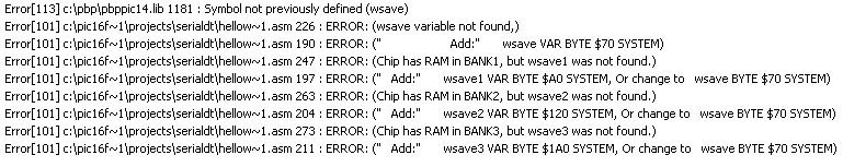

    I am very new to PBP, have done a good bit of research on Darrel Taylor's
    DT_INTS-14 ver 1.10. I really like what I have read on this Forum about it's
    abilities to do interrupts on HESRIN. I downloaded Darrel's package and started
    by trying his first sample (Hello World Toggling an LED) and found out Just how
    much I don't know about PBP. When I compile I get assembler errors.
    Is there link options that must be set for INCLUDE Files?
    Thanks In Advance for any direction.
    Attachment 0Name:  LINKERR.PNG

    Hi and welcome to the forum!
    I think it actually tells you what to do in the error message, ie try adding the followin to your code, before including the DT-INTS file:
    wsave VAR BYTE $70 SYSTEM
    wsave1 VAR BYTE $A0 SYSTEM
    wsave2 VAR BYTE $120 SYSTEM
    wsave3 VAR BYTE $1A0 SYSTEM
    Try to remember to include for which PIC you're compiling when posting, it makes helping easier.

    Thank you Henrik !!
    You are totally right that was the trouble.
    Sorry I missed that, Slow learner I guess.
    The PIC I'm Compiling for is a 16F877.
    Thank you again for your help!

    This is very interesting as I have had the same exact problem (AFAIK), same pic, PBP 2.60 and added the extra lines of code as suggested and still got the same error. I opened up DT_INTS-14.bas and found the following
    wsave VAR BYTE $20 SYSTEM ' location for W if in bank0
    'wsave VAR BYTE $70 SYSTEM ' alternate save location for W
    ' Comment them out to fix the problem ----
    wsave1 VAR BYTE $A0 SYSTEM ' location for W if in bank1
    wsave2 VAR BYTE $120 SYSTEM ' location for W if in bank2
    wsave3 VAR BYTE $1A0 SYSTEM ' location for W if in bank3
    I am using MPLABX v1.95 under Windows 8.1 I have used Darrel Taylor's code in the past using this chip (IIRC) but using MPLAB 8.x under Windows XP and never had a problem (except for typo's!) I can compile other code with this setup that doesn't include the Instant Interrupts and this is the first time I have tried to use Darrel's code on my new setup. I'm wondering if in fact I may not have something set up in MPLAB-X correctly? Any suggestions appreciated. Chris
