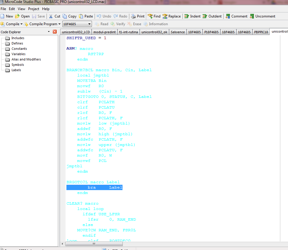

    mac file at 560 line (blued) is it normal that this piece of macro is in asm, aqua color ?

    Mar 2005
    CROATIA
    38
    Default Re: Error[126] c:\PBP\PBPPIC14.LIB : Argument out of range (2054 not between 0 and 2
    I have messing around this macro and line to which points this error126 (560)
    and it shows on
    BRANCH?BCL macro Bin, Cin, Label
    local jmptbl
    MOVE?BA Bin
    movwf R0
    sublw (Cin) - 1
    BIT?GOTO 0, STATUS, C, Label
    branch ?? .... so i was remarked branch line and error126 has disappear
    ok I must use select case-goto instead, but now i tried putting
    dummy 200 lines of
    lcdout "test test test"
    which increased hex for 3 times, but compiles correctly,
    so obvious there is some bug with branch keyword after code grows.....
    something like jump address can't be bigger then xxxx word....
    but i don't know much about macros and internals, so I'm happy to bound this bug
