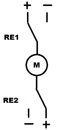

    I think you are making it more complicated than it really is....

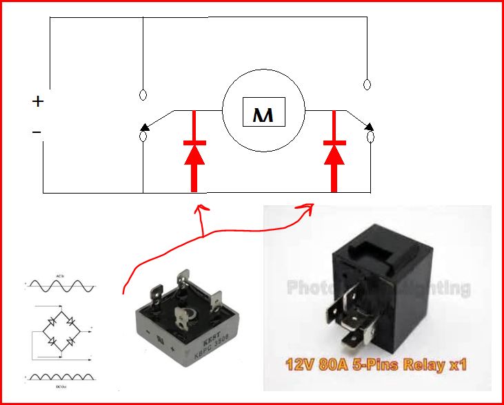

    If all you need is to be able to drive the motor in both directions as well as not drive it at all you need two SPDT relays (RE1 and RE2 in the below (very crude) schematic), each driven by an output on your PIC.
    Here's the crude picture:
    Name:  Relay bridge.gif
    Both relays are, as usual, drawn in their "inactive" state, both sides of the motor is connected to the positive side of the supply and no current will flow thru the motor - it won't go anywhere. To run the motor in one direction activate one of the relays, to run it in the other activate the other relay. If you activate both relays both poles of the motor will be connected to the negative side of the supply and the motor will not run.

    H, great explanation for the free-wheeling diodes circuit.
    about the bridge...... my experience but debatable
    -if the motor is 20-30-40 amps, the diodes should be at least 15 or 20 amp..... easy hookup with bridge (like you said)
    - 1,2, 6 or 10 amp diodes could short out..... too small ( even though the current is of short duration)
    -I saw 1 implementation where they put the '+' bridge connection to the '+' dc, but I think that those diodes are not needed and don't ever
    carry any current.
    - also should try to use FAST SWITCHING DIODES/BRIDGE, a little more expensive, reduces the doide turn-on-time, lowering voltage spike further.
    don
    Default Re: Electro-hydraulic actuator
    Hi Don,
    Actually, lets say the situation is the same as before, current flowing from left to right thru the motor. This time, in order to stop the motor, you switch the right hand side contact to its upper position. While the right hand side contact is open can you show me path for the current to circulate?
    If you connect a diode from each side of the motor to the positive rail as well there will be a path.
    The difference between a normal diode and a "fast switching diode" is not the turn-on-time, it's the turn-off-time or reverese recovery time as it's called.
    When the diode is forward biased and conducting current from anode to cathode its PN junction is charged. When the voltage across the diode is reversed this charge needs to be depleted before the diode is actually blocking the current. This means that the diode is actually conducting current backwards for a (very) short time before it starts to block it.
