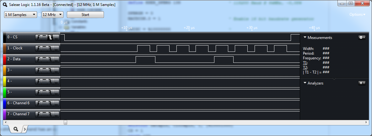

    I just tried it here, 18F25K20 running at 64MHz.
    TRISC = %10000000                       '
    TRISB = %00000000                       '
    Datapin var PortB.7    ;
    Clockpin var PortB.6   ;
    CS var PortB.5
    PortB = %00100000       ' Setup initial pin states.
    Pause 100
    Start:
      CS = 0
      shiftout Datapin, Clockpin, 1, [%10001000]
      CS = 1
      Pause 100
    Goto Start
    As you can see I'm using MODE 1 (clock idles low, MSB first). I captured the result with my logic analyzer:
    As you can see the datapin is indeed true before the rising edge of the clock, throwing some markers on it tells me that the datapin goes true 250nS before the rising edge of the clock signal but that will be different depending on the oscillator speed.

    Thanks for helping me with this. I don't know why my setup is showing the data slightly after the rising edge. I am using a similar micro (18f26k22), only I am using the internal Osc at 16MHz. Your output shows that the data should be good on both the rising and falling edge.
    Each SPI line I am using has a 3.9k resistor between the PIC's I/O and the device, but nothing else. (I have a resistor on the Clock, CS, DO, and DI signals)
    I like your logic output. I am using a pickit2 to load the hex file and program the Pic. I am wondering if I am missing out on some decent tools by not using MPLab.
    Default Re: Shiftout data needs to be sent on rising edge of clock
    Hi Jim,
    At 16Mhz you should have even more delay between the datapin going "true" and the rising edge of the clock - have you verified that it's actually running at 16MHz? (Can't see how that would actually make the data go true after the clock but anyway...)
    When capturing the output with your scope, are you measuring on the PIC pins?
    Are the PIC and the other chip both running off the same supply or are you doing some kind of level conversion with the 3.9k resistors?
    Try disconnecting one side of the resistor and measure again to verify that the PIC is actually setting the states correctly.
    I don't use MPLAB myself and the only thing I know I'm missing is source level debugging. As for the logic analyzer it's the Saleae LOGIC (8 channel version) - it's absolutely great for the money, worth every cent.

    I am happy with the Logic. At first when I opened the case I thought they forgot to package the device until I realized how small it is! Very nice device. I was only able to sample between 8MHz-12MHz for some reason, but for anayzing the SPI it was a nice clean signal. Being able to see the data sent/received in Hex was a nice bonus feature. The chip I am trying to control seems to be the problem rather than what I am sending. I am going to try looking at the hardware SPI on the PIC instead to see if it makes a difference.
