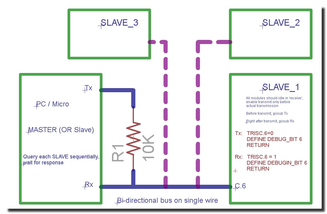

    This comm scheme sounds like ISO-9141. Been around for years.
    Default Re: Multiple PICs on usart network
    here you have

    Recently, I too needed to connect a couple of nodes to a common controller. I wanted a bus on which I could go on adding slaves "in parallel".
    Also, half duplex was acceptable in my application. This is the outcome: works like a charm along a 20 meter cable run at 9600 baud. I'm sure will run much longer at slower speeds..
    And, comms happen over a single line, so you also save a pin on the pic.
    Hope somebody finds it useful!
