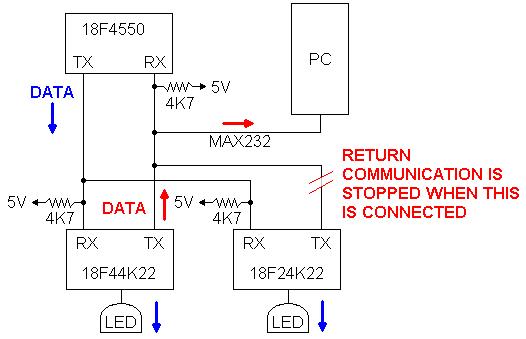

    This is what my circuit looks like:
    Name:  USART network.JPG
    - The 18F4550 sends 1 byte to the slaves on Master TX line.
    - Both slaves receive the byte properly.
    - 1st slave replies successfully with same byte on Master RX line.
    Problem: communication is blocked if 2nd slave is added on Master RX line.
    Note: 2nd slave does not reply to master yet, extra address byte will be added later so each slave will reply only when spoken to.

    This has been driving me nuts for several days. I've trimmed my programs down to this bare essential and I still can't see what I'm doing wrong.
    Everything works beautifully as long as I don't add that 2nd slave on the reply line.
    Last edited by Demon; - 22nd October 2012 at 02:16. Reason: PBP 2.60C, MPASM v5.46

    Hi Robert,
    I think the two TX-pins are fighting each other. When neither are trying to send they are both idle at high (or low, I can't remember). Then all of a sudden one is trying to send a bit pulling the pin low (or high) which effectively shorts the output thru the other slaves TX-pin. It doesn't matter that the second slave isn't actually sending anything yet, its TX-line is still pulled to the idle state of the line so when the other slave is trying to send its output gets shorted.
    What you could try is to "isolate" each slave from the masters RX-line with a 1k resistor. I'd probably remove the pullup on the masters RX-line as well otherwise it'll act as a voltage divider when the slave pulls the line low thru its "isolating resistor".

    Default Re: Multiple PICs on usart network
    Thank you.
    Your replies sent me on search for "rs232 multidrop" and that gave important note.
    "One Master PIC can talk to multiple slaves, but only 1 slave can connect back to Master RX."
    I had missed that fact if it was mentionned in the PBP manual, or anywhere else.
    I've since switched to an alternate solution.
    Thanks!

    or if not using diodes,
    2. After each Transmit, you may disable USART and make TX pin input pin. When you need to send again, make TX pin an output pin and enable USART, then transmit.
    If one TX line is an input pin, it will not effect the network during the transmission of other TX line.
    These two are only suggestions and are not tested.

    The URL I referenced in post #4 shows diodes in TX lines. There's no coding required. Schottky diodes would be best.
    http://cool-emerald.com/?p=711

    Mr Demon,
    I definitely solve this.
    You will need a couple of transistor per each Tx output and 3 resistor.
    As you said, if you disable the usart, also Rx line will be disable.
    If you use diodes, you will need a conversor as MAX 232...
    Problem with diodos, is due to signal keep positive if Tx is idle. Plus this, Impedance for Tx and Rx line are so sensitive.
    If want to communicate several PIC without using interfacing, you can do it using the schematic that I will post next.
    /jose p.

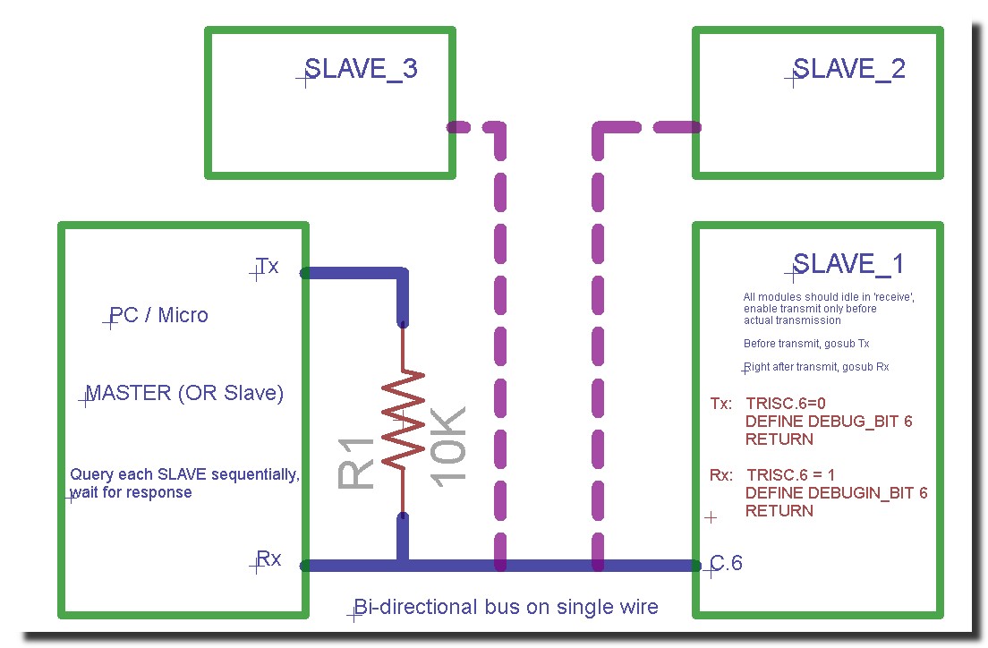

    Recently, I too needed to connect a couple of nodes to a common controller. I wanted a bus on which I could go on adding slaves "in parallel".
    Also, half duplex was acceptable in my application. This is the outcome: works like a charm along a 20 meter cable run at 9600 baud. I'm sure will run much longer at slower speeds..
    And, comms happen over a single line, so you also save a pin on the pic.
    Hope somebody finds it useful!
    Attachment 7684
    Hello Ardhuru
    It is a wonderful idea. I have not already thought about it.
    Great work!
    Would you please share some routine (source code) about your work?
    Andy
