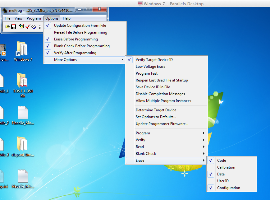

    Here's a screenshot of my settings:

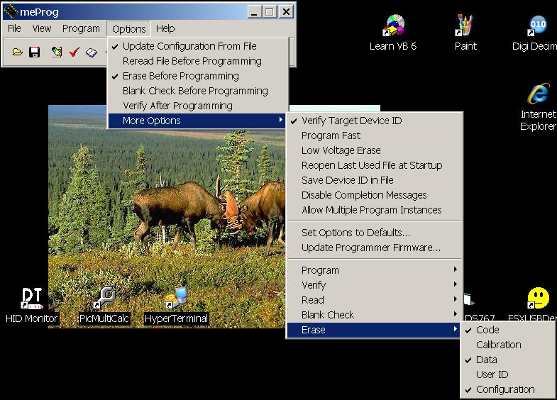

    I think you are interested in 3 things in particular: erasing before programming, programming and erase options.
    Here are my settings:

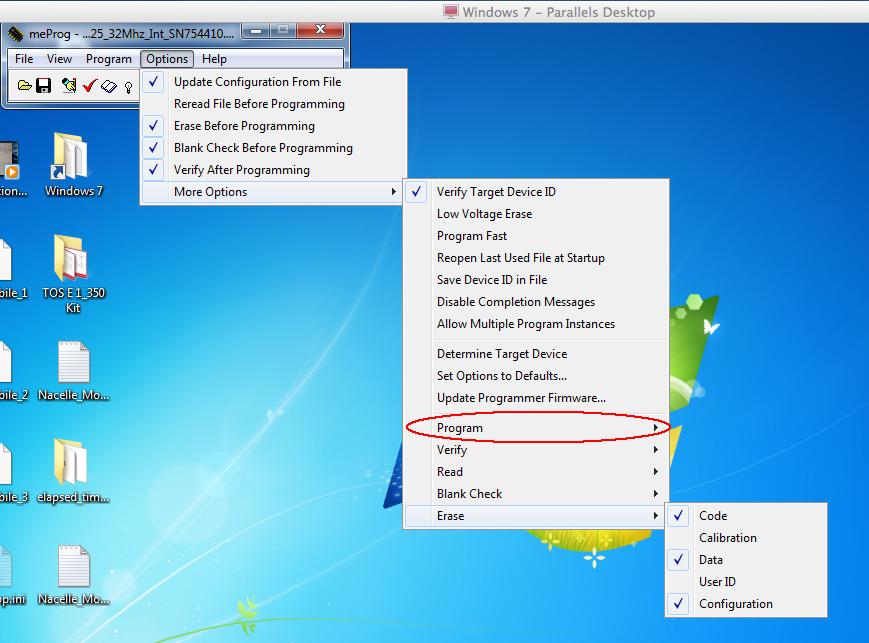

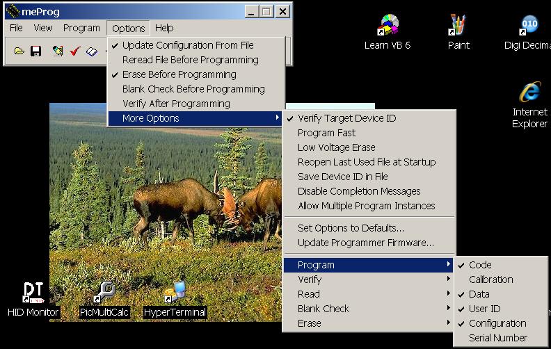

    Ross, what about your Program settings?

    I have the same settings except I also have the 'User ID' checked/enabled.
