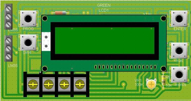

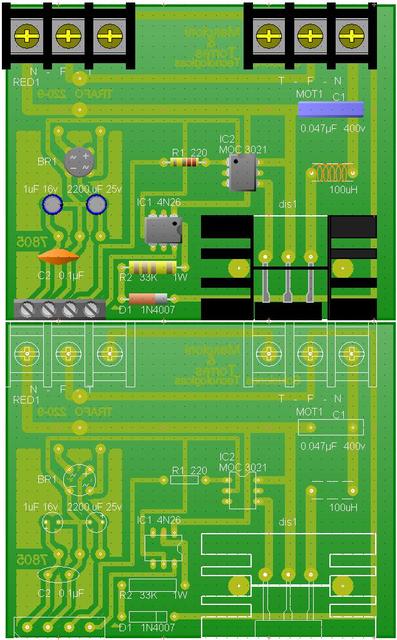

    The contactor coil can have 12 to 24-48cc / 110-220AC; For the case of implementing a contactor with AC coil, to my way of seeing things, the right thing would be to implement an opto-triac firing as auxiliary a triac, with the triac, the contactor coil excite ...
    I leave as an example a development arm for the company forces (economic heating fuel) two years ago ...
    Basically it is a simple fan controller, where the temperature program and then as sensing, turns on the fan to move the hot air on heating ducts.

    Notes on the triac, there is a legend that says: "100uH", there, the auto-inductance is housed with their respective toroid
