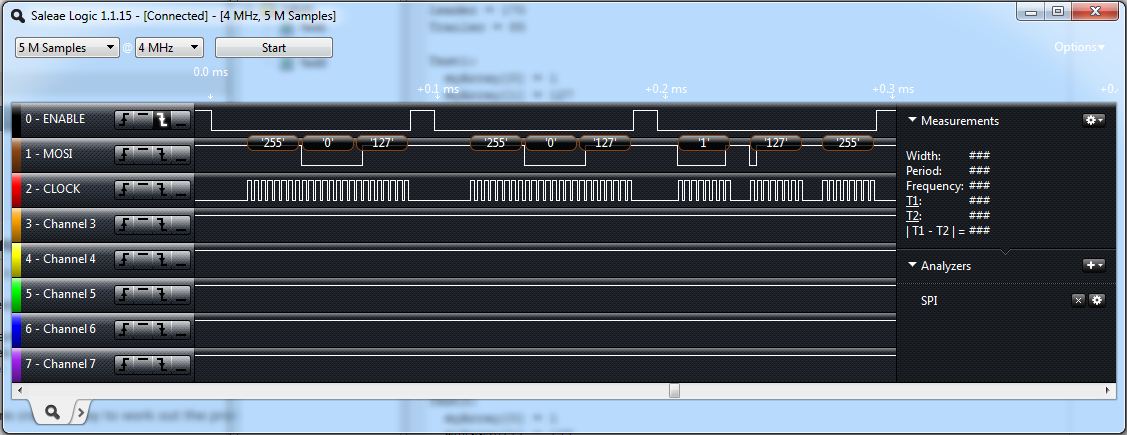

    I just did some tests here. Here's the testcode:
    Leader VAR BYTE
    myArray VAR BYTE[3]
    Trailer VAR byte
    Leader = 170
    Trailer = 85
    Test1:
      myArray[0] = 1
      myArray[1] = 127
      myArray[2] = 255
      PortB.5 = 0
      SHIFTOUT PortB.6, PortB.7, 1, [myArray\24]
      PortB.5 = 1
    PauseUs 10
    Test2:
      myArray[0] = 255
      myArray[1] = 127
      myArray[2] = 1
      PortB.5 = 0
      PortB.5 = 1
    Pauseus 10
    Test3:
      myArray[0] = 1
      myArray[1] = 127
      myArray[2] = 255
      PortB.5 = 0
      SHIFTOUT PortB.6, PortB.7, 1, [myArray[0], myArray[1], myArray[2]]
      PortB.5 = 1
    Pause 100
    The idea with the Leader and Trailer bytes was to see if the memory is alocated in the order it declared and if the shiftout would "fall into" those - turns out that's not the case in this example. Here are the captured results:
    I was a bit surprised that both test 1 and test 2 gave the same results but it did.
    That IS a bit suprising.
    But, it difinately shows that shifting out the array in the original post won't work, but doing it as seperate bytes of the array will work. So that is a 4th method that will work.
    Thanks Henrik!
