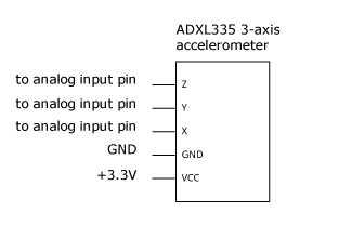

    Hi everyone, I'm planning to read several sensors(accelerometer, ambient, barometric, Temp and 5v battery) on PORTA using pic18F4550 on 5v supply. My first question is my accelerometer module has an analog output x, y and z with 3.3v supply...can I simply use ADCIN command for the accelerometer output pins?
    Thanks in advance,

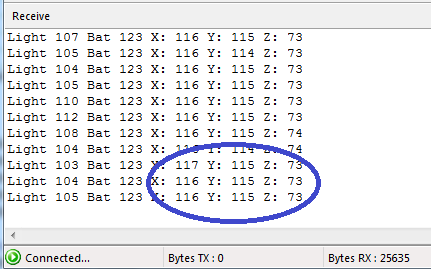

    I powered the accelerometer with a 3.3v with common ground to the PIC and read from its output pins (xyz) and here is the result.

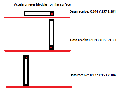

    I noticed that even if I rotate the module in any directions, the values are much like the same...

    What do you read if you connect a volt meter in-place of a PIC on the outputs of the ADXL335?
    Jun 2011
    Philippines
    223
    Default Re: Reading sensors with 3.3v(beginner)
    When reading with voltmeter varies on x,y and z pin (between 0 - 3.4v) when rotating the module.
    /tacbanon
    Hmmm,
    The module is working.
    You know how to use the ADC.
    I guess we will have to see your code to spot the problem...

    /tacbanon
    I am going to suggest writing a test code with that only reads the ADC in a loop with a serial output to the terminal. No interrupts.
    TestLoop:
     TOGGLE StatusLed1  ' faster process
     ADCIN 0, ambval
     ADCIN 1, batval
     ADCIN 2, axval
     ADCIN 3, ayval
     ADCIN 5, azval
     hserout ["Light ", DEC ambval," Bat ", Dec batval, " X: ",Dec axval," Y: ",Dec ayval," Z: ",Dec azval, 13] ' just to see it on the hyperterminal
     PAUSE 250
     GOTO TestLoop
    I see in your code a couple of things that might be causing an issue.
    @ INT_RETURN Remove this.
    error:
    Toggle led
    @ INT_RETURN
    And the TMR1 interrupt may not be long enough time wise for everything to happen that you have in it. The test code if it works will help track down the problem.
    Maybe someone else sees what I am missing though.
    Jun 2011
    Philippines
    223
    Hi Dave, thanks for helping me out, I did what you suggested unfortunately the same result...I will try to change some pin assignment and see if it will help.
    kind regards,
    tacbanon

    Default Acceleromter module test(3.3v) + Pic16F887 (5v)
    Hi, I did some testing but this time using PIC16F887 on 5v just to isolate the specific program which is to read the accelerometer module on 3.3v..using the following code.
    '' Program Start Here ''
    DEFINE osc 20           ' We're using a 4 MHz oscillator
    DEFINE ADC_BITS 8       ' Set A/D for 8-bit operation
    DEFINE ADC_CLOCK 3      ' Set A/D clock Fosc/8
    DEFINE ADC_SAMPLEUS 50  ' Set A/D sampling time @ 50 uS
    ANSEL = %11111111 ' Make AN0-AN7 Analog
    ANSELH= %00000000 ' Make AN8-AN13 digital
    accx var byte
    accy var byte
    accz var byte
    DataOut var Byte
    DataOut = 0
    '    PORT setting
              TRISA = %11111111   ' Set PORTA to all input
              ADCON1 = %0001001  ' Set PORTA.0,1,2,4,5,6 = A/D, PortA.3 = +Vref
              TRISC = %10000000        ' RC.7 => USART RX pin set to input
                                    ' all other pin set to output
             'OPTION_REG = $7f       ' Enable PORTB pull-ups
             TRISB=%00000000                ' RB<7:0> set to output
             TRISD=%00000000
    '    USART setting
             ' Since we will not use HSERIN/HSEROUT, we must
             ' write directly to internal PIC register
             TXSTA=$24              ' enable transmit and SPBRGH=1
             RCSTA=$90              ' Enable USART and continuous receive
             SPBRG=129          ' BAUD RATE = 9600 BAUDS
    '    Interrupt definition
             PIE1.5   =1            ' enable USART receive interrupt
             INTCON.6 =1            ' enable peripheral interrupt
        '    Alias definition
             RCIF       var PIR1.5   ' receiver interrupt
             UserLED1   var PORTB.0  ' the LED who show a 'running process'
             UserLED2   var PORTB.1  ' the LED1 that user want to control
             UserLED3   var PORTB.2  ' the LED2 that user want to control
        '    Variable definition
             Delay     var word     '
             DataIn    var byte     ' use to store RCREG content
             Discard   var byte     ' use to erase RCREG register
        '    Hardware/software initialisation
             PORTB=0                ' clear PORTB
             PORTC=0                ' dlear PORTC
             on interrupt goto USARTInterrupt
        PAUSE 500           ' Wait .5 second
    loop1:
        ADCIN 0, accx: ADCIN 1, accy: ADCIN 2, accz
        Hserout["Data receive: X:",Dec accx," Y:",Dec accy," Z:" ,Dec accz, 13]
        Pause 200
        GOTO loop1               ' Do it forever
    disable interrupt
    USARTInterrupt:
        '    Here's the interrupt routine who will make the user
        '    much happy by giving him the feeling to have the
        '    control on the machine when the status of the user
        '    LED will change
        RCSTA=0                     ' Disable serial port AND
                                    ' clear possible error (FERR,OERR)
        datain=RCREG                ' Get data
        while RCif                  ' wait untill the RCREG is empty
              discard=RCREG         ' by reading it and store result in a
        wend                        ' don't care variable
        select case datain          ' What to do with that data???
               case "1"            ' User selection = 1
                    userled1=1       '      => Enable the LED
               case "2"           ' User selection =2
                    userled1=0       '      => disable the LED
               case "3"           ' User selection =2
                    userled2=1       '      => disable the LED
               case "4"           ' User selection =2
                    userled2=0       '      => disable the LED
               case "5"           ' User selection =2
                    userled3=1       '      => disable the LED
               case "6"           ' User selection =2
                    userled3=0       '      => disable the LED
               case "a"           ' User selection =2
                    PortB=%00000111       '      => disable the LED
               case "d"           ' User selection =2
                    PortB=%00000000       '      => disable the LED
               end select
        RCSTA=$90                   ' Re-enable the serial PORT AND
        resume                      ' get out of here
    enable interrupt
    I have the following reading:
    and I think I'm not getting the right output...what might causing it?
    Kind regards,
    tacbanon
