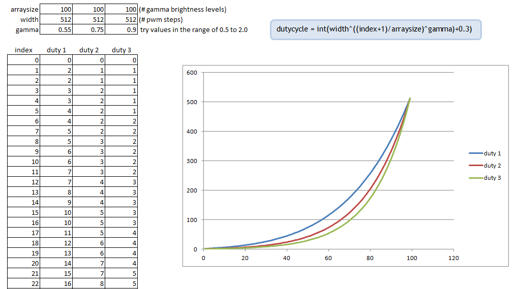

    Not sure if this will help but I created an Excel spreadsheet that charted the gamma "duty cycle" values generated by the "anti-log" formula in that simple JustBASIC program I use for generating the anti-log gamma tables. Here's what the Excel chart looks like;
    Name:  gamma chart.png
    And if you've forgotten, here's the program I use for generating the gamma brightness level correction tables (using the free JustBASIC program as well as an example of the output window;

    Mike...thanks for reminding me (I do recall your spreadsheet now)....it's a really nice utility, but doesn't allow me to go off-piste with some odd curves ....but in the light that there's nothing else forthcoming, I'll likely roll with that again :-)
