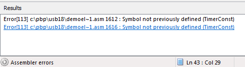

    Hi everyone, I'm trying out Darrel's sample code from http://darreltaylor.com/DT_INTS-18/elapsed.html.

    But I'm getting some error.
    I'm using pic18f4550, what do I'm missing in the process?
    Thanks in advance,
    tacbanon
    Default Re: Compiling error on Elapsed timer
    INCLUDE "DT_INTS-18.bas" ' Base Interrupt System
    INCLUDE "ReEnterPBP-18.bas"
    INCLUDE "Elapsed_INT.bas" ; Elapsed Timer Routines
    You need to use the 18F version of the Elapsed Timer.

    Thank you for the reply and for the great work DT...
