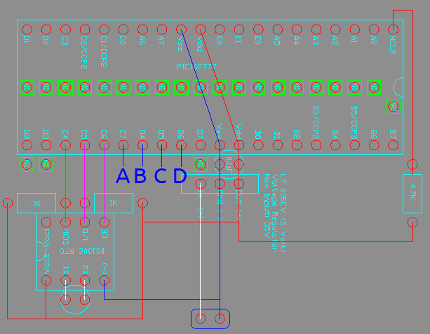

    Hi All,
    I cannot make a ds1302 RTC work with a pic16F777.
    I have used the RTC before with a smaller pic and that worked fine. For this project I need the 3 x HWPWM capabilities of the 16F777. I believe there is something wrong with the config settings - but I'm at a total loss for what the might be. Any help would be gratefully appreciated.
    In the code below, I've stripped it down so it should just be displaying the secondsLSB on a seven segment display
    Many Thanks,
    orjon.

    ...several day later - problem solved! Circuit was incorrect! Power connected wrong Vcc on DS1302.
