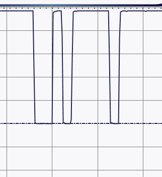

    I finally put a scope on it and tried to relate the command to the scope trace. This is what I got for $7A (brightness control, Ascii "z")
    When I write the binary version out, it is indeed $7A or %0111 1010, except it's back to front. What I would have expected to be the msb at the front end of the trace, is at the back end. In other words, what is being sent is not $7A, but %0101 1110. (At least when I used to demonstrate RS-232 signals, they used to follow that convention). Tell me if I'm wrong.
    So, what do you guys figure is happening? Maybe the inverted/true mode business? How do I choose either mode? I was looking at the REV command to reverse all the bits, but that seems rather "kludgy".

    I don't know where you ever thought that IEEE RS232 sent msb... They have been designing hardware USARTS with lsb for about 40+ years. You should Google RS232 protocol.... It's the LAW.....

    You're right, I'm an idiot. Of course it's lsb first. For some STUPID reason I was thinking the first bit was a STOP bit, not a START bit and got the whole thing wonky. It's been awhile since I've had to troubleshoot serial stuff.
    Okay, now I've got it and it's even more perplexing that this doesn't work since the display is getting the right code. When I send out [$7A, $55], that's indeed what I see on the scope.
    I think it's a timing issue and tried using DEFINE CHARACTER_PACING but that doesn't work either for values 1000 to 20000.
