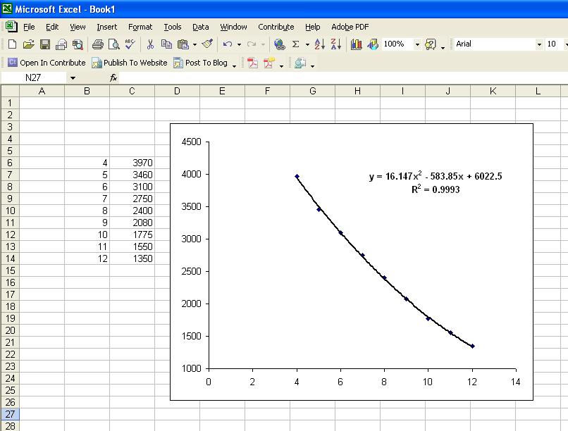

Very easy . Using data from your table and the column for Length = 13.85m,
First, plot the data as a X-Y graph. Then goto Charts -> Add Trendline. I chose a second degree polynomial for the approximation since it's clearly not a stright line. R^2=0.9993 refers to how close to been perfect is the line fitting approximation (R^2=1 is perfect).
