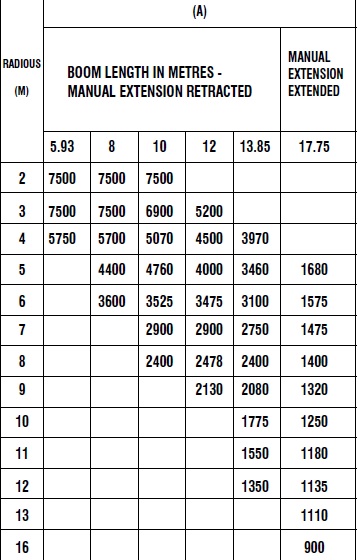

    To explain my problem in detail, here is the actual chart. Now I have 3 more charts like this as every chart belongs to one hook of the crane and there are 4 hooks in total. Name:  Chart.jpg
    As you can see above the radius ranges from 2 to 16. I have break it down to 0.1 increments for the sake of accuracy. So when I reach from 2 to 3, I already will have 10 values, then another 10 and in total around 140 values. Similar concept goes for the Boom length in meters @ 0.1 increments.
    Now I can get the reading of boom length and I can get my Radius value. Now based on these two values, I need to pick the value of the weight from this chart.
    Since I will have so many values, I am even doubting now if I can actually do it using an 877. I will go through your answers in detail later and see if it will be possible. Thanks for the replies.

    No, don't have formula for the weight. I will have to load the values myself into the memory.

    Here's one way to do it.
    You could have 5 lookup tables. One for each boom length. Say the boom is between 10 and 12 meters extended, so in between the values of your chart... For example the boom is at 10.5 meters, and radius is 5 meters. Do the lookup for the nearest known values, so lookup for the 10 meter, and the lookup for the 12 meter boom extension.
    4760 at 10 meter extension
    4000 at 12 meter extension
    Difference between the two extensions is 12 - 10 = 2 meters. We are at .5 meters over 10, so 1/4 the difference. The difference in load is 760 for the two lengths. So 1/4 of 760 = 190.
    4760 - 190 = 4570
    load at 10.5 meter boom extension, at 5 meter radius = 4570
    If you had a radius that was in between two numbers on the load chart, you could do similar lookups on the two radius's which the actual radius is between. Then do similar math.

    How accurate do you need the data to be? From your table for each column you can approximate and find a formula. The results can be very close to what you have. The formulas are very easy to get using Excel.

    Robert, I want them to be as accurate as practically possible. Of course I understand there is always a slight margin of error but lets see how this one goes. I knew that you can put formulas in Excel and get values but didn't knew that by putting values one can come up with formulas as well, so could you please explain more how to do it.

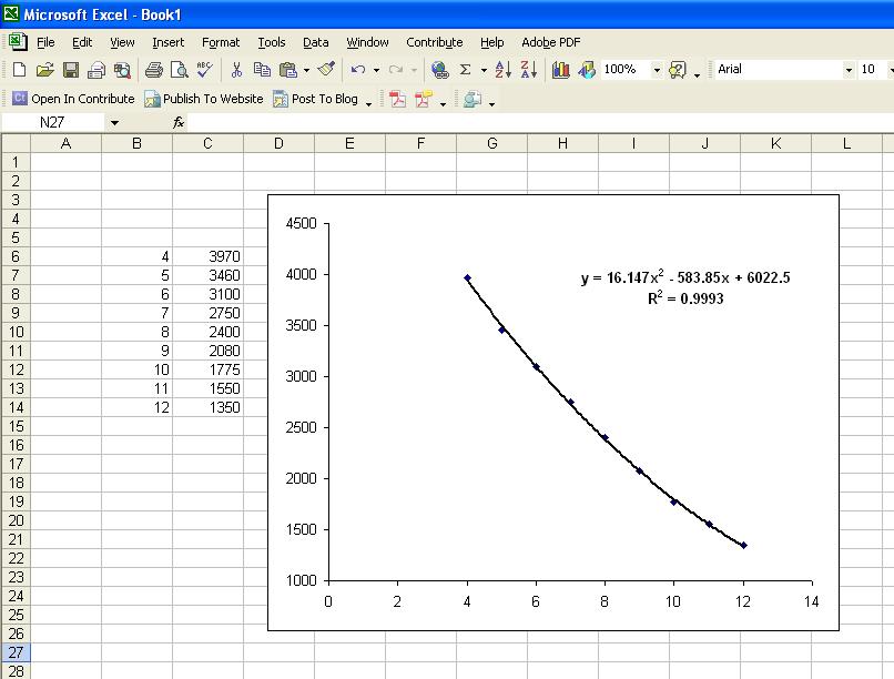

    Very easy . Using data from your table and the column for Length = 13.85m,
    First, plot the data as a X-Y graph. Then goto Charts -> Add Trendline. I chose a second degree polynomial for the approximation since it's clearly not a stright line. R^2=0.9993 refers to how close to been perfect is the line fitting approximation (R^2=1 is perfect).
    Robert, I also tried your method and found formulas for all the columns. Now I am trying to implement them, and I am facing a problem with calculations. For example formula for my first column comes to be :
    y = -875x^2 + 4375x + 2250
    RČ = 1
    Now my x is the radius. While calculating on excel sheet I just put 2,3,4 as radius values and their corresponding load in front. Now my actual radius is in centimeters. How do I calculate if I want for example 215 centimeters) OR (264 centimeters)? Should I make a new graph with radius in centimeters all the way from 200 to 400 or is there a better way to do it?

    Hmm, just a quick look. You can use the same formulas. The "in-between" values will be found in the formula by interpolation. But, if you use cm you might need to declare your variables as LONG instead of WORD

    			wSafe=wWeight1-wDummy
    		Else
    			If (wWeight2>wWeight1) then                                ; Same confusion as above
    				wTemp=((wBoomDiff*100)/bBoom_Jump)
    				wDummy=wTemp * (wWeight2-wWeight1)
    				wSafe=wWeight1 +wDummy
    			Else
    				wSafe=wWeight1
    			Endif
    		Endif
