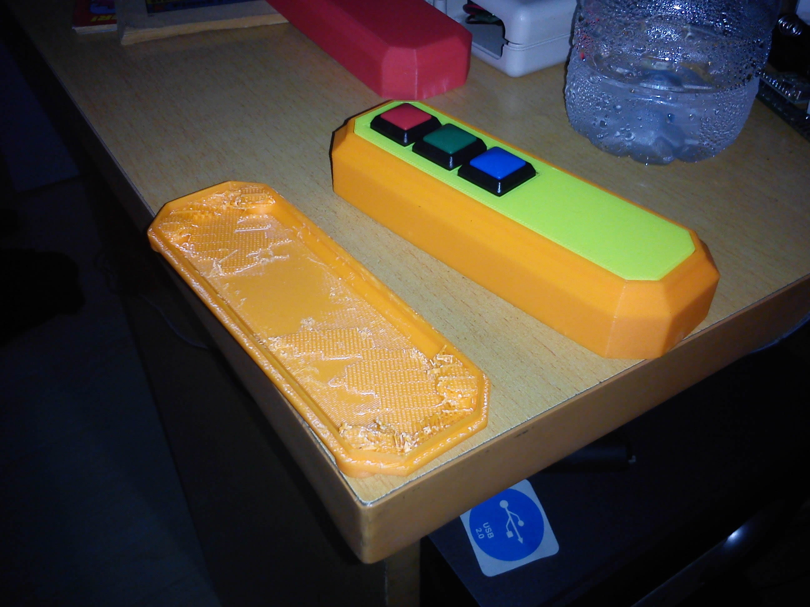

    We have probably all faced the problem with a need for an enclosure for our projects and usually it is really hard to get something nice that fits for a reasonable cost. At least I have and finally I decided to solve the problem once and for all. Enter my new friend the UP! 3D printer. (www.pp3dp.com)
    It prints out any 3D CAD object in a reaonable quality in ABS plastic fairly fast. The remote box below is made up from 3 parts that printed in less than 6 hours totally. That was with the smallest layer thickness (0.20 mm) and normal speed. With the biggest layer (0.40 mm) and normal speed the time will be cut almost in half. But the result has more visible lines. Also since this box needed alot of supports it also adds to the time.
    The "ugly" plastic that is visible on the bottom part of the remote is called "support" and is needed if you print something that has voids. All this is created by the UP! software and can be peeled away later.

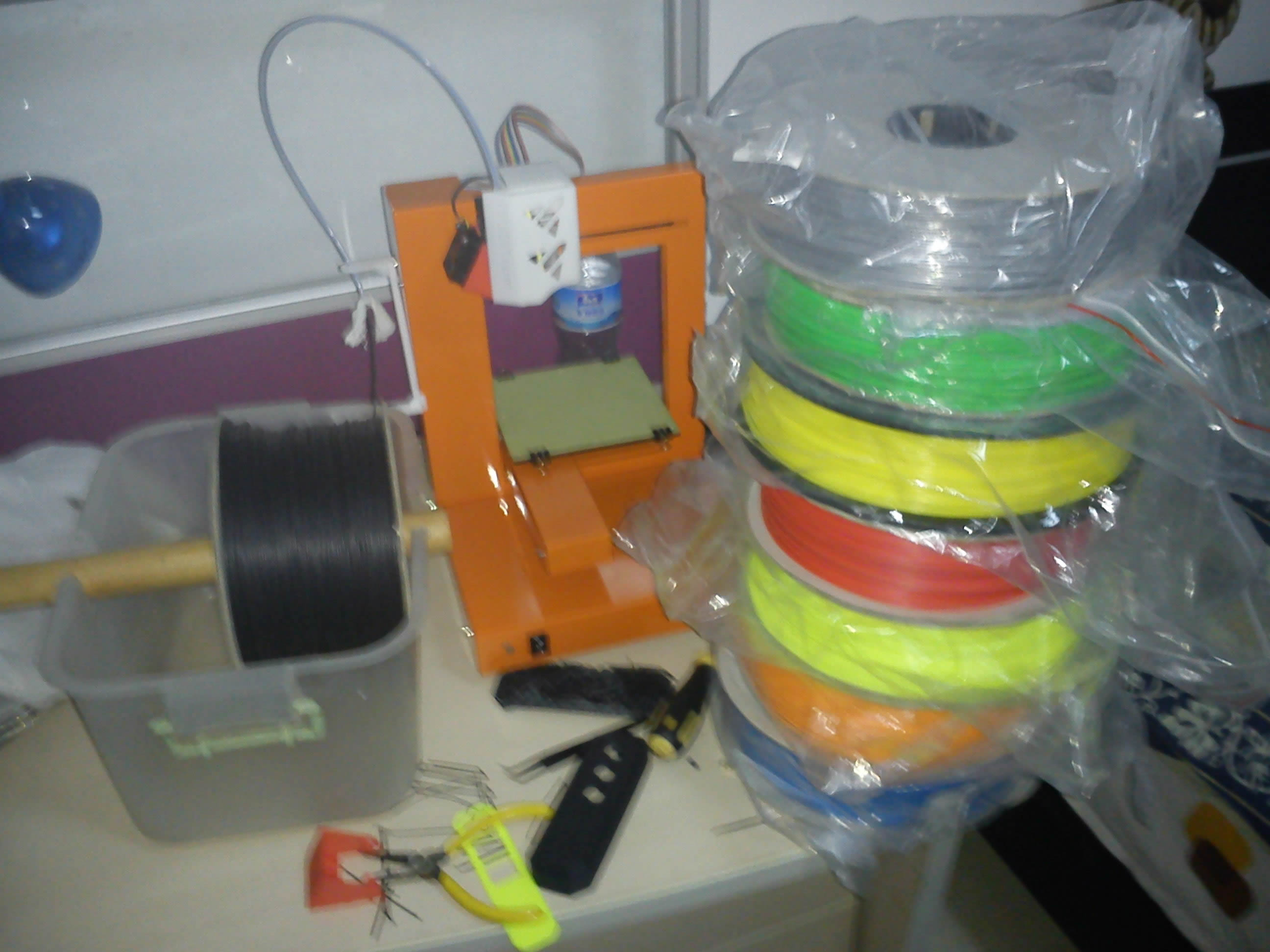

    Super silly simple to use. It took me 20 minutes from I unpacked the printer until I was printing the first model. Plug and play when it is the best.
    You make the part in any CAD software and then export the object in STL format. Import it into the UP! software and then set the quality level (speed) you want to have.
    Yes - it does become some visible lines on the finished part.
    Yes - it is a bit slow (but it is really quiet so you can print all night)
    Yes - the parts come out exaclty the same every time.
    From UP! there is for the moment only white ABS avaliable and their plastic is a bit expensive but there is several other places to get ABS for as low as usd $15 /kg + shipping. The machine has only one printer head so you can not mix colours while printing. The work area is not the biggest. Is it specified to 140 x 140 x 135 mm but the actual model size is more 130 mm since it is not that great in the extreme positions.

    Yes - I do believe that for the money spent and the time it will take to get started it is a really nice machine
    Well - They (UP!) have a newer machine called UP! Mini. It can print slightly smaller things but it did not feel as rigid as the UP! one does. Also it was not available NOW NOW NOW so... but it is much cheaper. I have not seen the Mini in action but all parts inside it was much thinner.
    Since everything comes with a price tag I can tell you the UP! is around usd$ 1500 and the Mini is around $900.

    As long as the enclosures or parts of it (use glue to build bigger things) can fit the work area I am sure it will work nicely.The parts becomes really strong and look nice.
