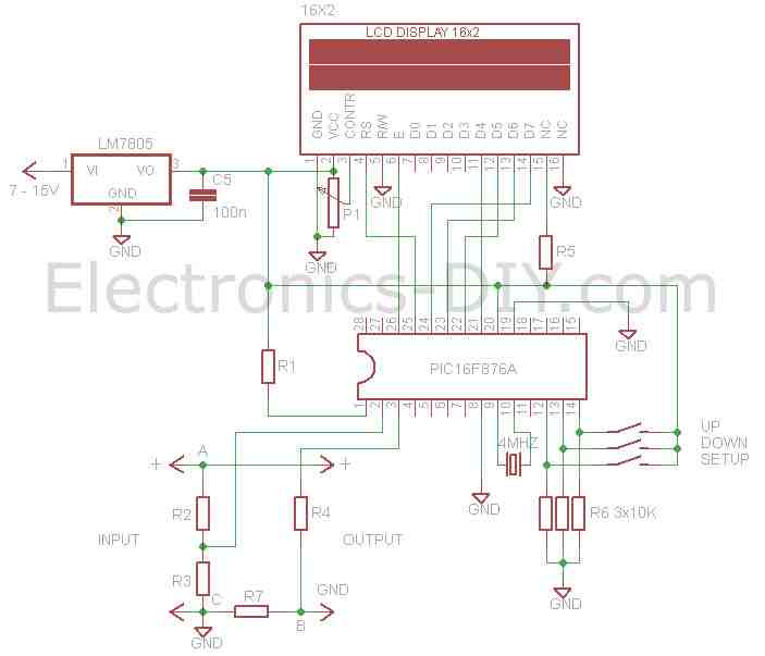

    I'm on a different computer to the one I program on, so I will load the code and schematic for all to see. The original link to this project is now dead, it had all the details plus the hex code.

    OK, hopefully I've attached the code and pdf of the project.
    Dec 2011
    IO93ok
    190
    Default Re: Trying to determine dc current - 12v lead acid battery charger
    Clearer view of the schematic as the one in the pdf is cutoff at the output.

    Is the 0R1 shunt resistor connected on the high side or low side of the load?
    If it is on the low side then you should only need one ADCin measurement; the second leg of the shunt being directly connected to ground.
    The maths becomes very simple, measure the voltage drop across the shunt resistor and scale directly to Amps or MilliAmps as required.

    The ADC divider circuits are shown seperate just below the output on the schematic. Note the arrowbox symbols are breaks in circuit diagram, the diagram is the original authors for whom I cannot give credit as all references are now dead.

    Hmmm interesting one http://http://electronics-diy.com/70v_pic_voltmeter_amperemeter.php
    This uses a .047 in ground line. I've just been out and bought a .047 3W resistor anyway, so will try a mod to my board and see if I can re-configure things around.
    Rob

    Whilst that higher resistor will give you 4x the ADC reading vs a 0.1R resistor, that's still only an ADC variance of about 60 steps between 1000mA & 300mA for a PIC supply of 5V....like I say, if you use a PIC where the ADC positive reference can be tied to it's internal 1.024V fixed reference (eg 16f1824), you'll then get a variance of about 240 steps between 1000mA & 300mA current draw ...which is starting to become useable.

    fratello. Yes I saw that one but it isn't this one, this one had various calibration routines etc in the code. Notice the defines for xtal osc. I do remember the author for mine came from India.
    Hank,
    I'm getting old I just don't get this. I've modded the board to have the .47 (not.047 as i put above) in series to the ground line and put a 100k to the adc input as per the schematic from the link above. This uses a 16f876 and I've duplicated the adc input circuit. They are claiming up to 10amp and with 10mA resolution.

    It's pretty simple...let me try & explain.
    If your PIC is running at 5V, then you're ADC resolution becomes 5V/1024 (the 1024 being 10 bits)...this results in a resolution of 0.0048828125V (4.9mV) per ADC bit, which sounds great, but not if your sense resitor is very small & therefore the maximum voltage drop will be very small. So at 1000mA & a .47 ohm resistor, your maximum voltage drop will be .47V across it (V=IR). ) .....so if you PIC has the aformentioned resolution of 0.0048828125V, then the maximum ADC reading you'll get is .47V/0.0048828125V ...or a max reading of 96 ...that's with 1A flowing (that's an awful lot of wasted bits, bearing in mind you've got 1024 bits available in your PIC).
    To get more resolution, if the PIC is modern & has a P-ref register for the ADC module (16f1828 etc)....you tell the PIC that rather than use 5V as the upper limit for the ADC, to use an internally generated fixed 1.024V instead (again the PIC needs to be up to date & have one onboard) - there are no more components involved, you just need to set a register in the PIC & you're off to the races.
    Now your ADC resolution becomes 1.204V/1024 bits ....or 1mV per ADC bit, therefore with 1A flowing through the sense resistor, your maximum ADC reading will be 470 which is a lot healthier amount of 'reading' to play with.
    Of course if you want up to 10A, then this is not the way to go (but I thought you were talking of 1A max?)

    Thanks Hank,
    That all makes perfect sense and is what I believed and kinda saw all along.
    I'm therefore puzzled by the circuit and claims for the above of 10A and 10ma resolution. This using a 16f876 which is the smaller brother of the 16f877 I have in the circuit.
    I've read the datasheets. Looked at the circuit, there's nothing different to what I'm doing. I see no offset input, it has no internal 1.024v ref, I'm also now in the ground line with the .47.
    This isn't the first circuit I've seen setup this way which claims 10A measurement with 10ma resolution but also using a 16f877. With 1023 bits to play with "it does not compute Captain"
    It is kind of correct..... 10mA through a 0.47R resistor = 0.0047V drop across it (which, if you look back above the above posts, with a 5V ADC reference & 1024 bits, you can resolve 0.0048828125V per ADC bit)
    the spec seems to have changed a little though ...I'd thought earlier on you were speaking of 1000mA being your maximum anticipated current ...if that were the case, then 10mA resolution didn't strike me as being that granular....however if 10A is to be your max current, then 10mA of resolution is just dandy! So I guess you need to bottom out your requirements & take it from there.....

    Hi Rob,
    If you plan to increase the maximum current from 1 Amp to 10 Amps then I would suggest that you change the value of the shunt resistor due to power handling ratings. 10 amps flowing through a 0R47 shunt resistor will need a hi power resistor (P=I^2 x R = 47 Watts).
    Your circuit shows the original 0R1 shunt resistor power rating as only 3 watts which has a theoretical limitation of just under 5.5 amps.
    Cheers
    Barry

    Thanks Guys,
    I probably confused you a bit.
    The 1000mA unit is the one already built which i wanted to upgrade to 5amp later. It used a .1 ohm resistor in the positive output which I removed and linked out. I then added a .47 in the ground leg.
    I then intended to design and build a multi function charger/desulphator unit which would probably be capable of 10amp.
    I would be quite happy with 10mA resolution on any of them. It's just that the counts I'm getting from the ADC just don't seem right anyway.
    I have another new 16f877 which i will test out.
    I mentioned the advertised unit because of it's specs and it's circuit. 3W .47ohm resistor in ground leg with 10amp measurement ? Capable of recalibration to greater amps?
    Probably a catchpa in the instructions when you get it.
    Rob

    As Barry pointed out, if you use a 0.47 ohm shunt and are planning to draw 10 amps through it, the resistor will need to be rated for at least 47 watts!!! Thats a lot of wasted power!! And one big honking resistor! What you may need to do is supply a Vref for the ADC that is lower than Vcc and use a smaller shunt resistor. Or put an op-amp across a smaller shunt resistor to amplify the difference. You may need to drop the shunt down to 0.01 ohm in order to get a reasonable sized resistor. That would be a 1 watt resistor. If you drop Vref down to about 1V, then should be able to get 1 mV resolution. With a 0.01 ohm shut, that would give you about 100 mA per step. So you may still need to use an op-amp if you want better resolution.

    I've looked at a shunt that I have for a 100A meter which I can use.
    Out of interest today I programmed the code that fratello posted and tried it on my board after changing the lcd defines etc.
    RESULT !
    Well, the voltage code is incorrect BUT the current code works just fine. Now if only I could get my head around the language used

    Finally success with the 'current' routine.
    I've been completely puzzled by the readings and results so I rewrote the code just to get the adc counts.
    The adc count for the current input mirrored the current output of the unit. Great, now just alter the code again and run.
    Hmm no joy, it was out again by a long way. So I isolated the code to study the routine, no it was correct. Then I wondered why the routine should be so far out from the count. Logic said it wasn't the count but something else. So I checked the defines. Argh, the ADC osc had been commented out and I had another oscon0 that set it at 8Mhz.
    Changed the adc back to internal rc osc and the routine now worked.

    Regarding the 0.47 ohm resistor.
    As it's in the ground leg am I not correct in thinking the power rating is different, as it's current is say, 1amp, but it's the voltage drop across the resistor that counts which is in mV.
    Put it this way with real world on the board. On the positive output it ran quite warm at 1amp. In the ground leg it is still cold at 1amp.
    It doesn't matter whether the resistor is 'in line' with the 12V supply wire ....or inline with return to ground wire....the same current will be present (the current leaves the charger, goes through the battery & returns to the charger's negative reference .....one current path if you like)
    If it was hot before & it isn't now, then that can only mean one of three things...
    1. You had more than 1A running through the resistor in its original position.
    2. You've not got 1A running through the resistor in it present/new position (what does a DVM say the voltage drop is) ....at 1A through a 0.47R resistor, should see a voltage drop across the resistor of 470mV. You've got 470mW being disppated across the resistor...which I reckon should be warm to touch.
    3. You somehow connected the resistor in situ wrong....it should sit between the negative return wire from the battery & the circuit's 0V reference.

    Thanks for your parience Hank. Sometimes I wonder where my head is. I know all this, but I've been in a blank place since having the head cold, amazing how I can't think straight.
    As for the heat, I realised later that the .1 was in series with regulator which runs quite hot, there was heat transfer. The .47 is in the ground leg which is nowhere near the reg.
    The unit is running fine now and the basic (sic) software works, now I need to add the frills such as logging to eeprom, temperature compensation etc.

    OK I've given up on this board and I'm going to design my own and start again. There's something peculiar happening with it. I had it working just fine and left it to one side running but not connected to the test battery for a while. I was busy on the bench making up a temperature and memory board.
    Later I connected the test battery and nothing happened to the current but the output was suddenly 7.9v ?? So I disconnected it, switched off and then tried again a minute or so later. It powered up fine gave the correct output but now the current routine was way off. I checked against a multimeter.
    I suspect the LM317 is playing up.
    On another tack, this months (June) QST has an interesting article on carrying batteries in a cooler box. What interested me was the authors use of a steel 3/16th (4mm) setscrew to make a high current shunt.
    He used nuts and wire tags to make the shunt and calibrated against a multimeter by adjusting the nuts along the thread length till he got it correct. At the head end he used two nuts to clamp two tags tight, then at about 1 inch (25mm) he used two nuts again to clamp two tags. This end he screwed along the thread length to get the right reading. Quite novel.
    Pic added with acknowledgemen to QST.
