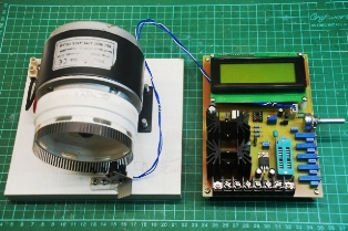

    I am endeavouring to put together a closed loop motor speed controller using Henrick's "incPID" routine. The end use for this project is to re-power my 9x20 lathe using a treadmill motor (180Vdc 2HP). For my trial project I am using a 24Vdc 500W electric scooter motor. My ultimate goal will be to maintain constant motor speed under varying mechanical load conditions.
    I have read everything I could find on this forum related to PIC control and I believe what I am trying to achieve should be "do-able."
    I have successfully put together a program based on the 16F684. I have managed to write code that will read a speed pot setting via ADCIN (10 bit) on AN0 (Pin 13) and successfully drive the 24V motor via HPWM output on CCP1/P1A (Pin 5). The PWM signal is fed to the motor via a low-side MOSFET with a suitable transistor drive circuit. Having achieved this, I then went to the next step and tried to implement the PID routine. My code is as follows:

    I have also attached a copy of the circuit diagram
    [attach]incPID_16F684[/attach]
    Obviously, I am not having the success I want - otherwise I would not be telling you all this
    I have tried to simplify my setup by eliminating the feedforward terms and by setting the integral and differential terms to zero. In essence, I am looking purely at the proportional control in the first instance and, once that is under control, I propose to tweak the system using the other available terms.
    As shown in the code, I have set pid_Out for single quadrant control by setting any potential negative drive to zero. I have made various attempts using values of Kp ranging from $0100 to $0900 but in all cases I only get varying rates of "bang-bang" output (ie output switching from zero to pid_Out_Clamp). I thought of looking at some of the variables on a 16x2 LCD but decided this might create its own set of timing problems and decided against it. I am not sure where to go or what to do next. Does anyone have any suggestions?
    One thing that has always confused/concerned me with the HPWM statement in this program; pid_Out is a WORD variable (16 bits) but the PBP manual states that duty cycle in the HPWM command only ranges from 0-255 (8 bits). Am I missing something here?
    For the record, I am using PBP 3.0.1.1, MCS 5.0.0.0 and the Melabs U2 programmer.
    I would greatly appreciate any assistance to help resolve my problems with this code.

    Two things I have realised since sending the initial post:
    1/. In the circuit diagram, U3 should be 7805, not 7812
    2/. I forgot to mention that my feedback is gained from a photo-interrupter/encoder wheel configuration mounted to the motor shaft. This feeds an LM2907 - Frequesncy to Voltage chip. The output from the LM2907 is adjusted to give 0-5V (stop - full throttle).
    Cheers
    Barry
    Default Re: incPID Routine - Help Needed
    You seem to be approcahing the project in all the correct ways, what you describe is most certainly doable and I honestly can't see why the output would swing between the extreme ends like you explain, especially with a gain of only $0100.
    Can you replace the feedback voltage with another pot? Then, with a gain of $0100, you should be able to adjust the output with EITHER the setpoint pot or the feedback pot. Dissconnect the motor and just observe the output untill you get that working. I'd also try to get the variables output etiher to a LCD like you say or over a serial line to the PC.
    One thing I do see though is that you have the pid_Out_Clamp set to 511 but as you say the HPWM command only accepts a dutycycle of 8 bits (0-255) so I'd set the pid_Out_Clamp variable to 255. You could always try copying pid_Out to a BYTE-sized variable and use that varaible in the HPWM statement but I don't think that is the real problem.

    Hi Henrik,
    I have had a high degree of success with this project today.
    I disconnected the motor and replaced the feedback voltage with another pot as you suggested. I was able to get some very nice PWM signals showing on the scope. I think a lot of my problems last night were caused by a dodgy MOSFET. It failed under load this morning and the whole system fired up nicely once it was replaced.
    To tune the system I added two more pots; one for Kp and one for Kd. I also connected the LCD which helped me greatly in seeing what was happening. The motor I am using doesn't have alot of inertia so Kp and Kd terms are relatively small for a tightly tuned system response. So far, so good.
    I am a little confused with your velocity feedforward section. pid_velocity_cmd is initially set to zero and your program comment states that this variable is "set by the main program." From what I can find, this variable is only used in the calculation for pid_Vel_ff and pid_Acc_FF. If this is the case, it will always remain zero (as will pid_Vel_FF, pid_Acc_FF and pid_LastVelocity_Cmd). Am I missing something?
    For my trials I ended up setting pid_Vel_FF manually just so the output could overcome what little insertia the system does have.
    There is still a fair bit left to do on this project but before I do much more I need to transfer this circuit from my breadboard to a PCB. I am sure a lot of the instability I am seeing on my scope can be attributed to the breadboard (switching currents, ground loops etc.)
    Your return comments on the feedforward situation would be greatly appreciated.

    The shaft encoder is a photo interrupter with a disc - 100 steps per revolution.
    I made the disc myself so I can adjust the number of steps quite easily.
    I did a sanity check on the shaft encoder but counting the number of steps per second using a simple COUNT routine and displaying the result on the LCD. I then compared the result with a non-contact hand-held digital tacho. The two results were near identical - I was very happy with the accuracy of my system.
    I have just finished assembling the PCB (see attached) and hope to do some testing on it tonight.

    Looks nice. An a big motor!
    Wish you good luck Barry.

    I adjusted the speed of the motor such that the pulse train frequency from the photo interruptor was under 200Hz.
    Each loop of the main program gives me a valid reading for #TMR0 and #newCount but there is no correlation between the numbers.
    To be honest, I don't really see how there could be. TMR0 doesn't appear to be reset anywhere so it should just roll over from 255 to 0 each time the maximum count is reached.
    When/how does TMR0 start and stop counting?
    You did say in your last post that we would take this "one step at a time."
    First step completed - we are now counting pulses. What next?
    If I understand the process correctly, we need to set up one timer (say TMR0) as an accurate interval timer (say 10ms) and the other timer (TMR1) as a counter for the pulses. As the interval timer ends its cycle, the value of the counter is returned as ADValue for the PID routine. Am I on the right path here?
    I look forward to your "next step" suggestions.
    Cheers
    Barry

    Hi All,
    I have had a bit of time to think about where I am going with this project and what my ultimate goal is.
    As stated in my original message
    I could spend time tweaking the current system, change the PIC (along with the extended learing curve associated with the new settings) but is it really worth it? At this stage I have proved the concept using the 24Vdc motor; proved it well enough to move forward to the final platform. I have decided to take the plunge and jump straight to the full blown design. Yeah, scary huh!
    The final system will require forward and reverse motor operation. This will be achieved using four IGBT's configured in an H-Bridge arrangement. The IGBT's will be fired by dedicated high-side and low-side gate drivers. All control circuitry will be isolated from the power circuit by opto-isolators (5kV isolation). Forward, reverse and stop (emergency) functions will be performed by switches on digital I/O lines, speed to be set by ADCin via a pot, feedback via photo-interrupter/shaft encoder wheel with an interrupt driven counter (eg. TMR0 and TMR1). As in the prototype system, gain terms will be set via individual pots with ADCin routines. Settings to be displayed on a serial LCD.
    I have searched the Microchip website for an appropriate device and decided on the 18F2431. Quite a powerful device with lots of in-built functions dedicated to motor drive applications.
    I now have lots of new information to try and get my head around. The 18F2431 datasheet is mammoth! I plan to piece the circuit diagram together, lay out a new pcb and then begin to learn the ways of driving the 18F2431. This won't happen overnight - but it will happen
    Thanks to all those who have helped me get to this stage. I am sure I will be calling on you again in the very near future.
    Any recommendations, suggestions or comments on what I am trying to do, before I embark on this adventure, would be greatly appreciated.

    It has been quite some time since I last posted on this subject. A lot of water has flowed under the bridge since then but I am pleased to advise that I have my 1500W H-Bridge power board up and running via PIC18F2431 in PCPWM mode.
    I have forward, reverse and emergency stop functions operating on a test motor (24V 200W scooter motor) and nice clean rotary encoder signals from a home made encoder wheel and IR photo-interrupter - 60 steps per revolution.
    My next stage of the project is to try and implement your incPID routine.
    My question is this: Should I take the approach you outlined above (ie use DT-Ints to set up a timer interrupt at around 100Hz and then feed the pulses to another timer/counter) or would there be a better way of doing it on the 18F2431 using some of the available Motion Feedback modules?
    Your advice and direction would be greatly appreciated.
