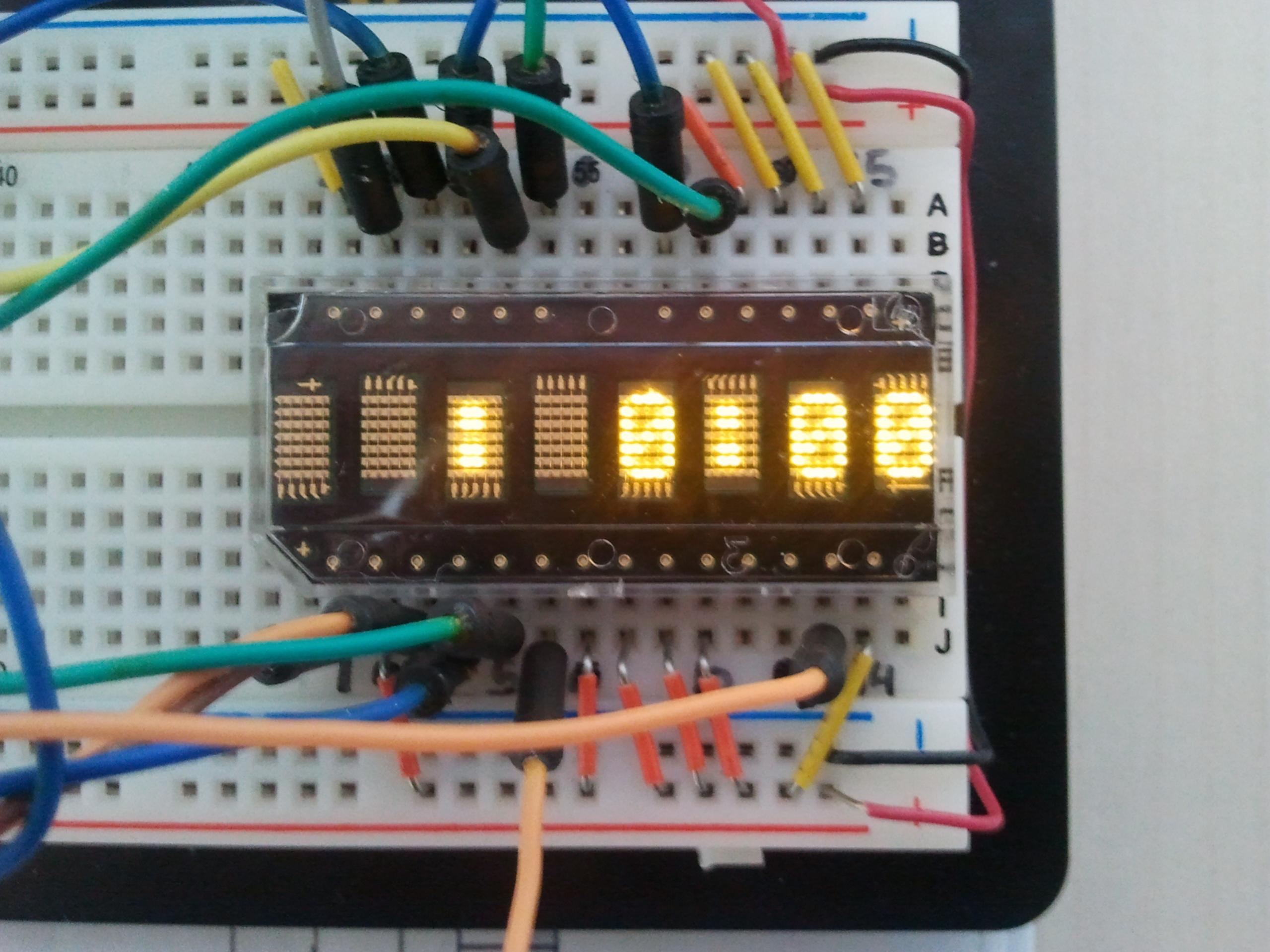

    Hi friends,
    I know that this is a really old topic, but, last week I got 3 of this display for free from a friend.
    They are nice, bright, and has a good "retro" looking.
    I did many many tests and I was unable to get a stable result from the display. They are brand new, never used.
    I test the Rentron´s Hello moving message an the clock published here.
    Both, I get ramndom characters and a strange behavior.
    I´m using a 16F877 @ 10 Mhz (I did tests @ 20 Mhz also)
    Name:  2012-06-07 12.34.37.jpg
    I´m using the wiring suggested by rentron :
    '* // Display connections * //'

    Have someone here ever used this kind of display ?
    thanks !
    Sérgio
    Sao Paulo - Brazil
    92
    Default Re: Hdsp 21xx display
    Hi friends !
    I did find my problem.
    I was using a really noisy power supply.
    Afeter changing it to another one, everything is working fine !
    Thank you !
