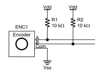

    Based on another example I've order this encoder. As far as wiring up to a PIC goes, does this schematic look right?

    Default Re: Motor Speed Control via Single Poteniometer?
    Yes, the wiring is correct. You could use the code snip given @ http://www.picbasic.co.uk/forum/showthread.php?t=12911
    to start counting your encoder pulses.
    Cheers
