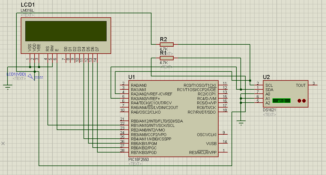

    May 2012
    6
    Default Re: Problem with I2C
    Here you can see the circuit
    You do not have
    DEFINE OSC XX
    in your code
    What speed is the OSC source?
    It is best to set up an LED and make it blink at a known rate before you jump into anything else to be sure of your setup.
    Sorry that I did not see this before
    Try
    ADCON1 = %00001111
    You have AN0 - AN7 as analog.
    AN0 - AN4 on the 2550

    Default Ds1621
    I got a good laugh out of this one.
    When the code doesn't work, rewrite PBP's I2C commands ...
    Try this ...
    DEFINE OSC 48
    CLEAR
    #config
        __CONFIG    _CONFIG1L, _PLLDIV_5_1L & _CPUDIV_OSC1_PLL2_1L & _USBDIV_2_1L
        __CONFIG    _CONFIG1H, _FOSC_HSPLL_HS_1H & _FCMEN_OFF_1H & _IESO_OFF_1H
        __CONFIG    _CONFIG2L, _PWRT_OFF_2L & _BOR_ON_2L & _BORV_3_2L & _VREGEN_ON_2L
        __CONFIG    _CONFIG3H, _CCP2MX_ON_3H & _PBADEN_OFF_3H & _LPT1OSC_OFF_3H & _MCLRE_OFF_3H
        __CONFIG    _CONFIG4L, _STVREN_ON_4L & _LVP_OFF_4L & _XINST_OFF_4L
    #endconfig
