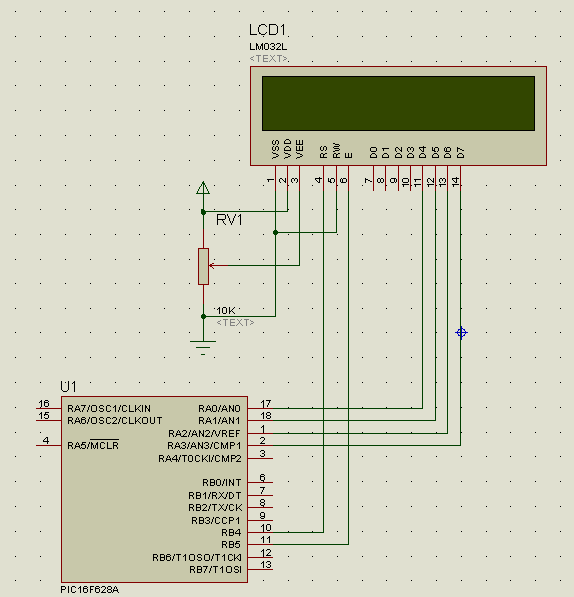

    Default Re: pulse counter 16f84a
    I compiled the code as:
    Define LCD_DREG PORTA
    Define LCD_DBIT 0
    Define LCD_RSREG PORTB
    Define LCD_RSBIT 4
    Define LCD_EREG PORTB
    Define LCD_EBIT 5
    default is 4 bits, unless defined, so since it is not defined, it is 4 bit bus. So Port A0, through A4 go to the D4 through D7 on the LCD. Since PortB was defined for both RSREG and EREG, RSBit is portb.4 and EBit is portb.5. If you need me to change those, let me know. But again, you can compile yourself with the 15 day free trial version.
    Here is a picture of the connections. There is similar information in the PBP manual.
    http://www.scalerobotics.com
    thank you so much for the picture of the connections.according to picture i should connect pin 15,16 with a 4mhz crystal and pin 4 to 5volt right.after putting your hex code in pic i should use pin 12 for puls input.and lcd will show the freq.am i right?
    thanks so much for your help.you are great.
